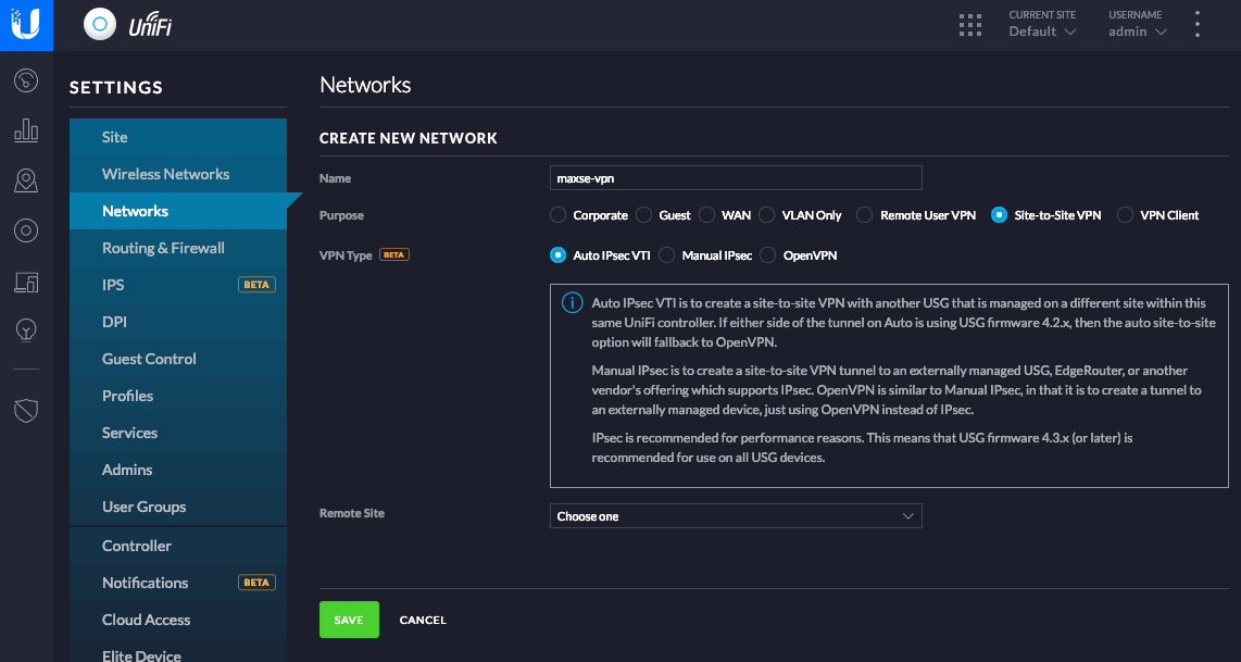

EDIT: creating a VPN in UniFi takes around 3 seconds once your sites are configured. Just needs a name, selecting site-to-site-vpn, choosing the site and clicking save. :)

okay thanks so much. Looks like unifi is the answer. Is it going to be something that's always enabled? Both t he VPNs always connected to each other? I would like the process to be automated, so I doubt there's a way for the VPN to know once the backup is complete... So no issues with it always being connected?

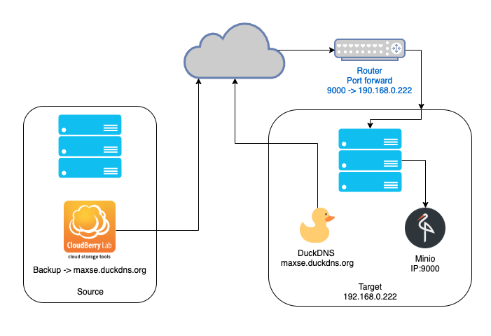

What might work is having an Ubuntu VM on your source machine with CloudBerry + OpenVPN client.
On your target machine have another VM with OpenVPN server + Minio.
10 hours ago, maxse said:
Seems like cloudberry supports Minio by clicking on S3 compatible cloudstorage and entering the Minio details. Found that on google, is that correct?
No clue on if it actually works, but it would be easy enough to try. The target machine would just need to have the Minio docker installed, and either a static IP or some flavour of dynamic dns to allow your machine to find it. No need to have a vpn or run a VM. You will need to set up a forwarding rule in the remote router to allow the single outside port to go through to the minio port on the remote server.

Niceeeee, wow you guys are too good, haha with diagrams and all! This is it, will try this.
Will I be able to try this on my own local network first to see if this will work before bring the backup server into its remote location?

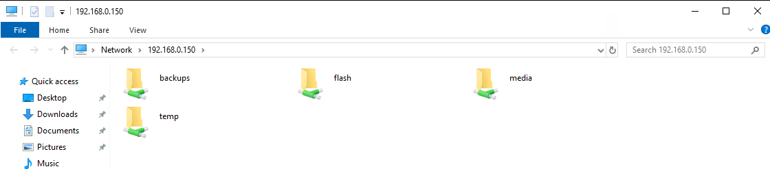

Define browse . GUI ? Via a share? Taking the drive out and plugging it In somewhere?
I mean it's going to be connected to the network at a friend's house. So anyone in that home will be able to browse to the server on the market and just see the file names.
I know they won't be able to just plug the drive in somewhere else because the drives will be encrypted also, but it's going to be always on and the dirve is unlocked when the array is running, just the cloudberry encryption, which doesn't obfuscate the file name in the linux version of the software?

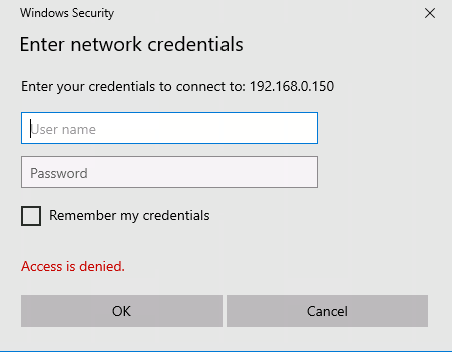

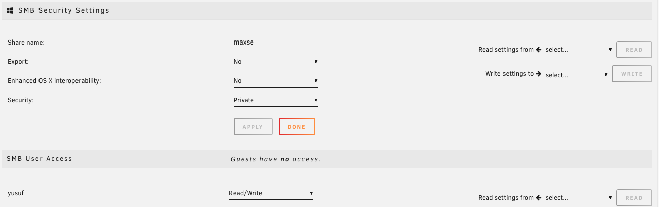

Am i missing something? If you mark the share as private and don't Export it how will they be able to access your files?
Here's me creating a share
  1. Name =  maxse
  2. Export = no
  3. Security = Private
If they browse to your server and you do have some Exported shares they will see this. Not much they can do with that unless you name one of your shares "XxX HardCore...." then they might have some suspicion that your storing some non PG stuff.
If by some miracle they figure out your share name and try to browse to it .
If you had your share as Export = yes (hidden) They would still get a prompt asking for credentials.
And besides, you don't have to create a share anyway for Minio. just manually create a folder under /mnt/user and pass that to the container as the location to store the data.
