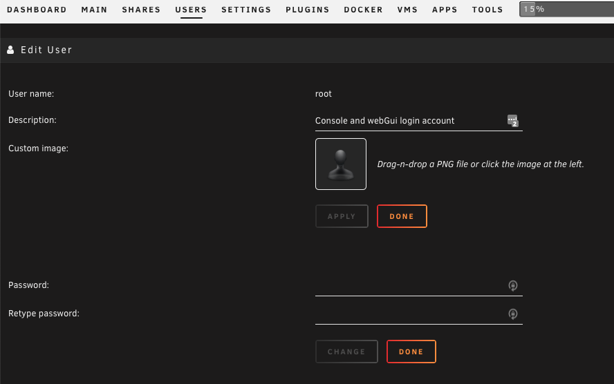

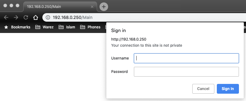

Silly question, but can the webui be password protected by setting a user password?
ive never bothered setting up users or any passwords in the past 5 years on unraid 5. But I was the only user and didn’t open it up to the internet and never had backups.
You are a security nightmare :P
Ofcourse you can set a username and password for the UI.
It's the root user. Go to Users > Root
Set the password for that account. Next time you login:
