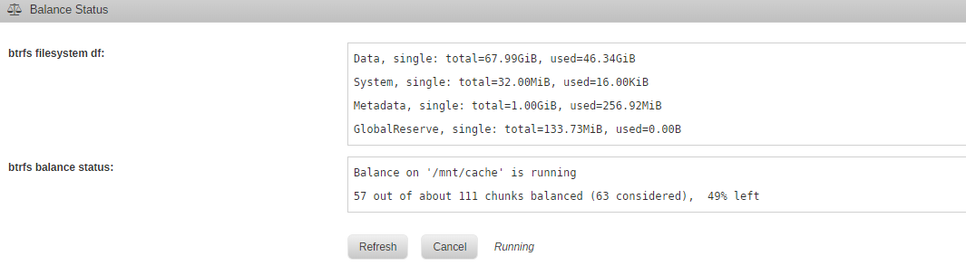

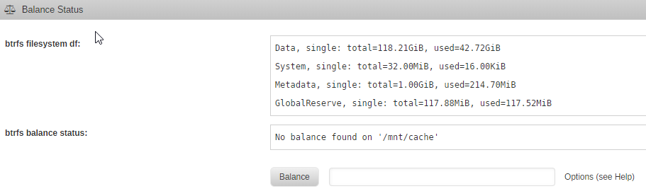

Okay, so I disabled the docker (the vms were already disabled) and started the server. It finally mounted again.
I tried to runt he balancing command, but did did not work...
root@LKNServer:~# btrfs balance start -dusage=75 /mnt/cache
ERROR: cannot access '/mnt/cache': No such file or directory
and the web interface shows:
and the Balance button does not seem to work either...
I am also going to do what @limetech said lower (
) by moving everything out of the drive, formatting and putting things back on.
I have started the mover to get things off the drive naturally to see if that can do all the work for me.
I have temporarily marked the usually cached shares as Yes instead of Prefer so I can move them out of the cache.
Edited by lankanmon

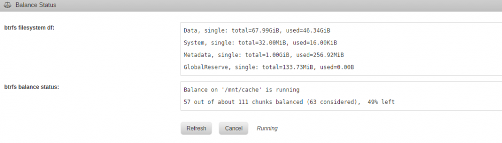

2 hours ago, johnnie.black said:
I have the command running right now. It appears to be working and am at 50%
I just wanted to know what I need to know after this is done... will the drive automatically no longer be read-only?
Do I need to restart?
Also, I ran it with -dusage=75 Do I need to run it again with a bigger number and is the max 100?
I just want to know what I can do to prevent this from happening again.
UPDATE:
It just finished and I got this error:

Jan 27 14:36:58 LKNServer kernel: BTRFS info (device sdf1): found 7445 extents
Jan 27 14:36:59 LKNServer kernel: BTRFS info (device sdf1): relocating block group 369414176768 flags data
Jan 27 14:37:06 LKNServer kernel: BTRFS info (device sdf1): found 6155 extents
Jan 27 14:38:54 LKNServer kernel: BTRFS info (device sdf1): found 6155 extents
So, what should I do now?
Edited by lankanmon
added update
Okay so I went back and looked at the other thread and saw that, if it failed, I had to run the command with a smaller param.
So I went back and ran it again (each time) with
-dusage=1
-dusage=10
-dusage=25
-dusage=50
-dusage=60
-dusage=70
-dusage=75
Each time, it did succeed. Then after that, I restarted the server and it seems to work now.
I would still like to know if I need to use a larger number (greater than 75) and what the limit is.
Also how often I must run this command and if there is a way to automate this process.
BONUS: What is btrfs scrub status? and do I need to run that as well?
I want to thank all of you for your help. I really appreciate it!
