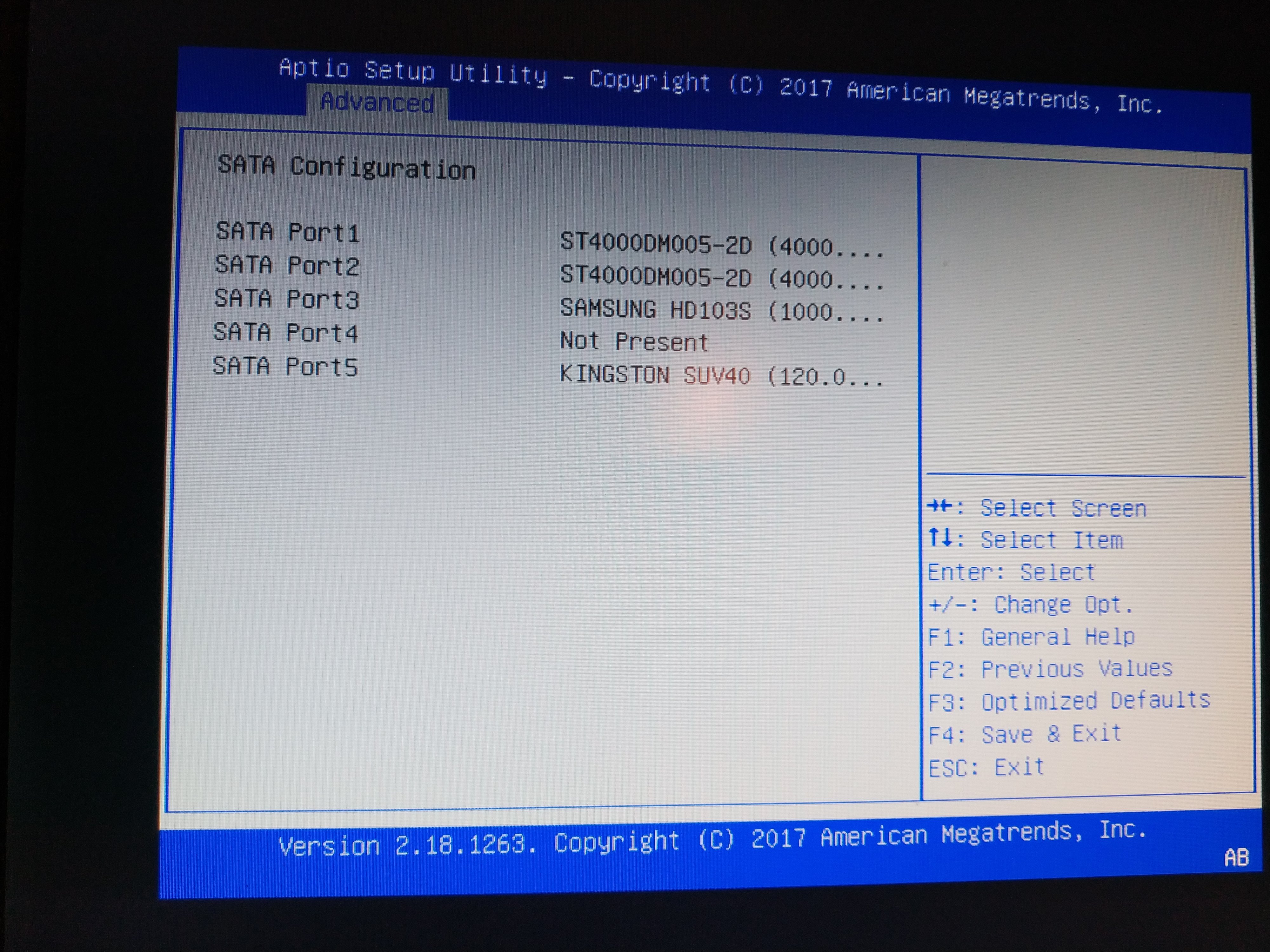

No devices are being detected other than the SSD, check connections and bios, until the drives are detected in the bios they also won't be detect by Unraid.
Bios see the disks.

It might have been an intermittent issue, disks should still be detected in normal mode, if it happens again likely a miniSAS cable problem, or PSU.
Thanks guys, I didn't touch the disks, they are mounted directly on to a back plane so I hope it's not a problem there. I'm away now for the weekend so I'll restart in normal mode when I get home incase it doesn't see the disks again. I'll let you know how I get on.
