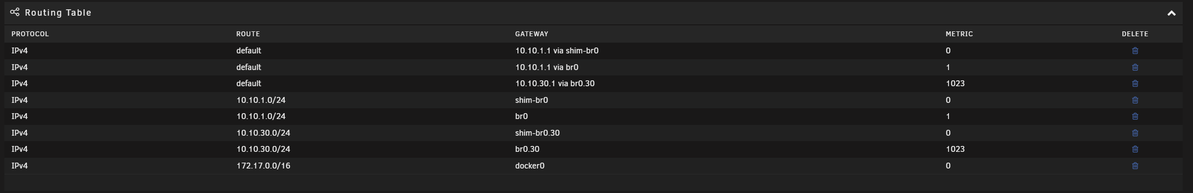

October 10, 20233 yr so i read everythink and the related posts. i simply can't get it work, even with docker restart, enable host access and vice versa. "sysctl net.ipv4.conf.all.forwarding=1" does not solve it as asll. Even though the the IP adress from the custom bridge does look good. I'm not a linux expert, is there anything i can do to double check or try? I'm actually lost and don't know what to do anymore. I'm only able to run my dockers on br0 or on host, but not on my VLAN (30) br0.30. Thanks for any kind of advice. I'm happy to provide more information, just let me know. Maybe this helps as a start (br0.30 is my problem child) Edited October 10, 20233 yr by aViN187
