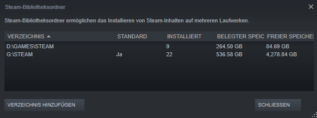

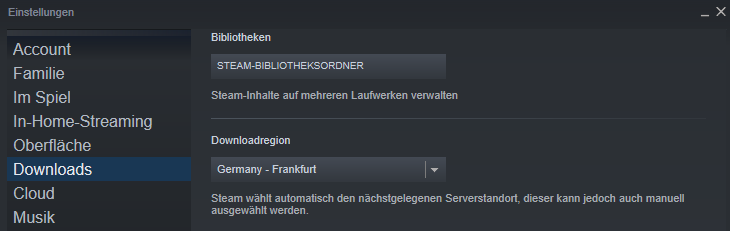

In Steam this is my main location for installing games to. In Unraid I've created a share called GAMES and in Windows i mounted the share with the drive letter G and in Steam >>> Settings >>> Downloads >>> Library I added these network drive. Whenever i install a game i can choose where to install it to and installed games i can shift between both entries.
The loading times for games sitting on the share on the array are way longer than on the dedicated SSD. It doesn't matter if you do it my way or using a extra vdisk sitting on the array. Sure you can place the vdisk on the cache drive if it's big enough to hold all your games. You also can put the vdisk on an unassigned disk (HDD, SSD, NVME) to not interrupt any caching of your files happen or slowdown any Docker or VM performance sitting on the cache. It all depends how your cache is setup and how large it is. Most games for me if they once loaded up from the array share they are running fine. Loading times for levels sure are longer but other than that it's ok. That might differ from game to game. Some copy protections or anti cheat tools will prevent you from starting up games from a network share. Couple people reported Uplay have some issues. It's up on you to test which game works with which configuration.
There are a couple improvements you can do inside the VM to increase the performance in the VM. For example setting the power plan to high performance, disable hibernation etc. You might check out SpaceInvaders Youtube channel if you're not already did. He has tons of useful stuff setting up VMs and configuring/tweaking stuff or use the search on the forum.
https://www.youtube.com/channel/UCZDfnUn74N0WeAPvMqTOrtA

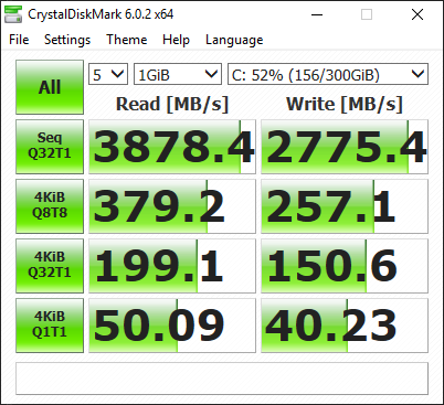

Host Storage:
    2 x NVMe Samsung 960 EVO in Unraid Raid-0 with btrfs set as cache drive without a lot of Dockers or other services that use the drive much
VM Storage Settings:
    Raw image file, set to use the SCSI driver in the VM, with the Discard="UnMap" option set (Trim goes all the way from VM to the real drives...)
CrystalDiskMark 6.0.2 x64 (C) 2007-2018 hiyohiyo
                          Crystal Dew World : https://crystalmark.info/
* MB/s = 1,000,000 bytes/s [SATA/600 = 600,000,000 bytes/s]
* KB = 1000 bytes, KiB = 1024 bytes
   Sequential Read (Q= 32,T= 1) :  3878.403 MB/s
  Sequential Write (Q= 32,T= 1) :  2775.437 MB/s
  Random Read 4KiB (Q= 32,T= 1) :   199.059 MB/s [  48598.4 IOPS]
 Random Write 4KiB (Q= 32,T= 1) :   150.607 MB/s [  36769.3 IOPS]
  Random Read 4KiB (Q=  1,T= 1) :    50.087 MB/s [  12228.3 IOPS]
 Random Write 4KiB (Q=  1,T= 1) :    40.228 MB/s [   9821.3 IOPS]
  Test : 1024 MiB [C: 52.0% (156.0/299.7 GiB)] (x5)  [Interval=5 sec]
  Date : 2019/02/03 7:23:40
    OS : Windows 10 Professional [10.0 Build 17763] (x64)
For reference, the official specs for a single drive running bare metal on a good system:
Sequential Read Speed    Max 3,200 MB/sec
Sequential Write Speed   500 GB: Up to 1,800 MB/sec
RANDOM READ (4KB, QD32)  500 GB: Up to 330,000 IOPS (Thread 4)
RANDOM WRITE (4KB, QD32) 500 GB: Up to 330,000 IOPS (Thread 4)
RANDOM READ (4KB, QD1)   Up to 14,000 IOPS (Thread 1)
So definitely not a straight up 2x performance boost from the Raid-0...  Some performance is given up on my system due to having to request storage from the host on every write, and release that storage back to the host on every delete...  For me however I originally had several issues with the drive filling up and killing the performance of my VM's, this was all eliminated by switching to the SCSI driver with Discard (TRIM) enabled, as this made the storage self regulating...  Most of the real limiting factor is trying to max out two by 4x PCIe lanes for each drive through the PCH then to the CPU...  This maxes out the connection between the PCH and CPU on my system, and so is the real limiting factor...
