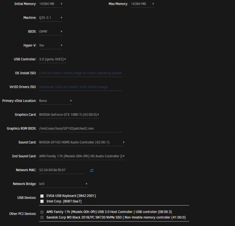

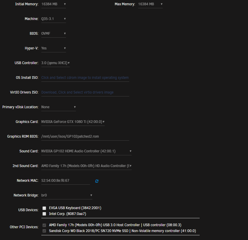

This is my current vm, the xml is heavily customized but you should get the idea from here. There is no vdisk location as I've passed through the NVME controller that you see on the bottom.
As far as extra vdisk images, just check when they were last modified, and if there are any existing vms that point to that .img.
