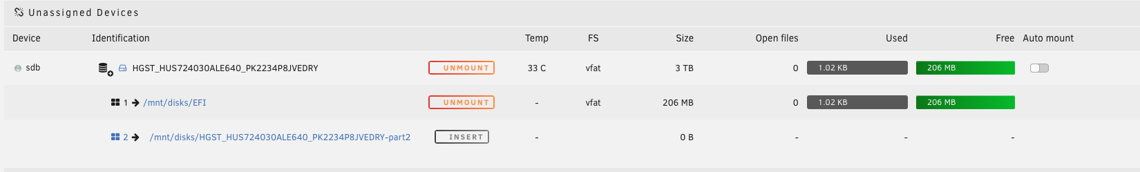

Beginners steps but need help understanding why a HDD connected via USB to the server and showing in the unassigned devices as shown in the picture attached, is not giving me access to its files nor via the Krusader docker when setting up the Krusader container and adding a Path or device.
I only use this Docker and would like to transfer files from the HDD to the Server.
The original format in this drive is APFS yet the FS shown in the UD is displayed as vfat.

Click on the + by the device.  It appears you have multiple partitions.
Absolutely correct,

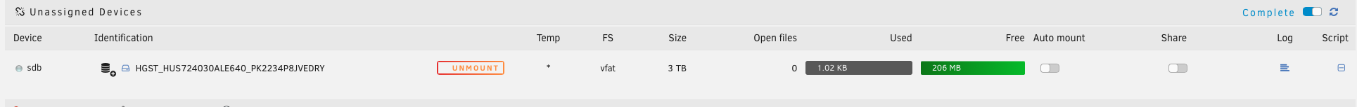

I believe I have addressed it correctly as shown in the attached image, yet the files are not visible. I have unmounted and mounted with no luck on gaining access to the HDD files. I am pretty sure I am missing a very obvious step but I am only learning how to walk at this stage. Could you please give me a second vector?

Your second partition probably has the data you are looking for but there is no recognizable partition.  It is the partition that shows the 'Insert' button.  What format is the second partition supposed to be?
Hi dlandon,
The HDD was initially formatted on apple file system after they changed to the new file system. The drive appears on my MAC and I can access the files. For some reason the 'sdb' shows vfat and can't read APFS. So back to square one.
The entire HDD is supposed to be APFS...
