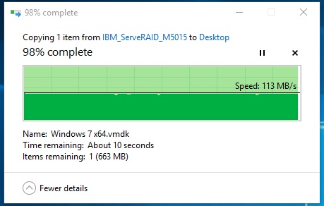

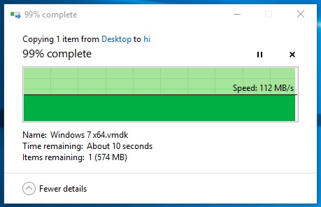

I've made progress. Found an Acer i5-650 system in the basement with 8gb ram and threw Windows 10 on an SSD into it. After updating all the Windows Updates and throwing in an Intel PCIe network card, I was able to achieve this..with no changes to the unRAID server. Tested on unRAID 6.6.6
Previous tests were with a (higher end hardware but windows 7 system with onboard nic).
No magic config. Fresh install of Windows 10 and an Intel PCIe network card. Thats it.
Will test with the onboard nic in that system and report back.
First Pic is WRITES TO the unRAID server
Second Pic is READS FROM the unRAID server

Unfortunately no. And it pisses me off. The client (i7-3820, Asus Maximus MB, 32GB ram, intel ssd boot drive, all WD black drives) was a Windows 7 system. It has served me well for 6 years (since last re-install), and can WRITE to various servers (ubuntu, freenas and unraid) all at over 100 MB/s. When reading from the arrays, it would max out at 65 MB/s like clockwork, across 3 different server OS (with a slight bump in speed reading from ubuntu).
I changed 4 variables (yes I know thats bad lol) at once to get a solid 112 MB/s R/W speed.
Different Hardware (lower power Acer prebuilt i5/8gb/120gb ssd)
Different OS - Windows 10 (albeit fully reinstalled and "fresh")
Different Network Card
Different Port/Cable on the switch
I will not dedicate more than 1 more hour to tracking down what went wrong, as I was looking for an excuse to upgrade to Windows 10 so take advantage of installing (without kijigering) natively on an NVMe boot drive.
Offending client that was capped at 65 MB/s read speeds from unRAID (network RX) was using an;
-Intel 82579V Gigabit Network Adaptor (onboard)
I'm unaware if this has known issues with unRAID, but the server shouldn't care what chipset of card is on the other end as long as it can handle GbE
My goal was to get full speed from unRAID, and I have. If that requires a different network card or a different OS so be it.
