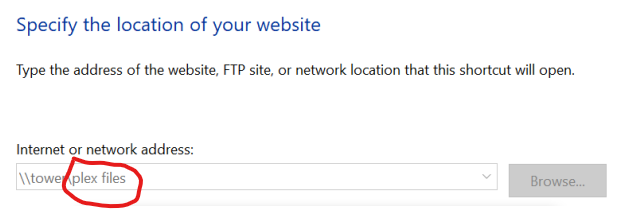

@mattiscg, you are looking for this  share:
When the Share name is actually!
