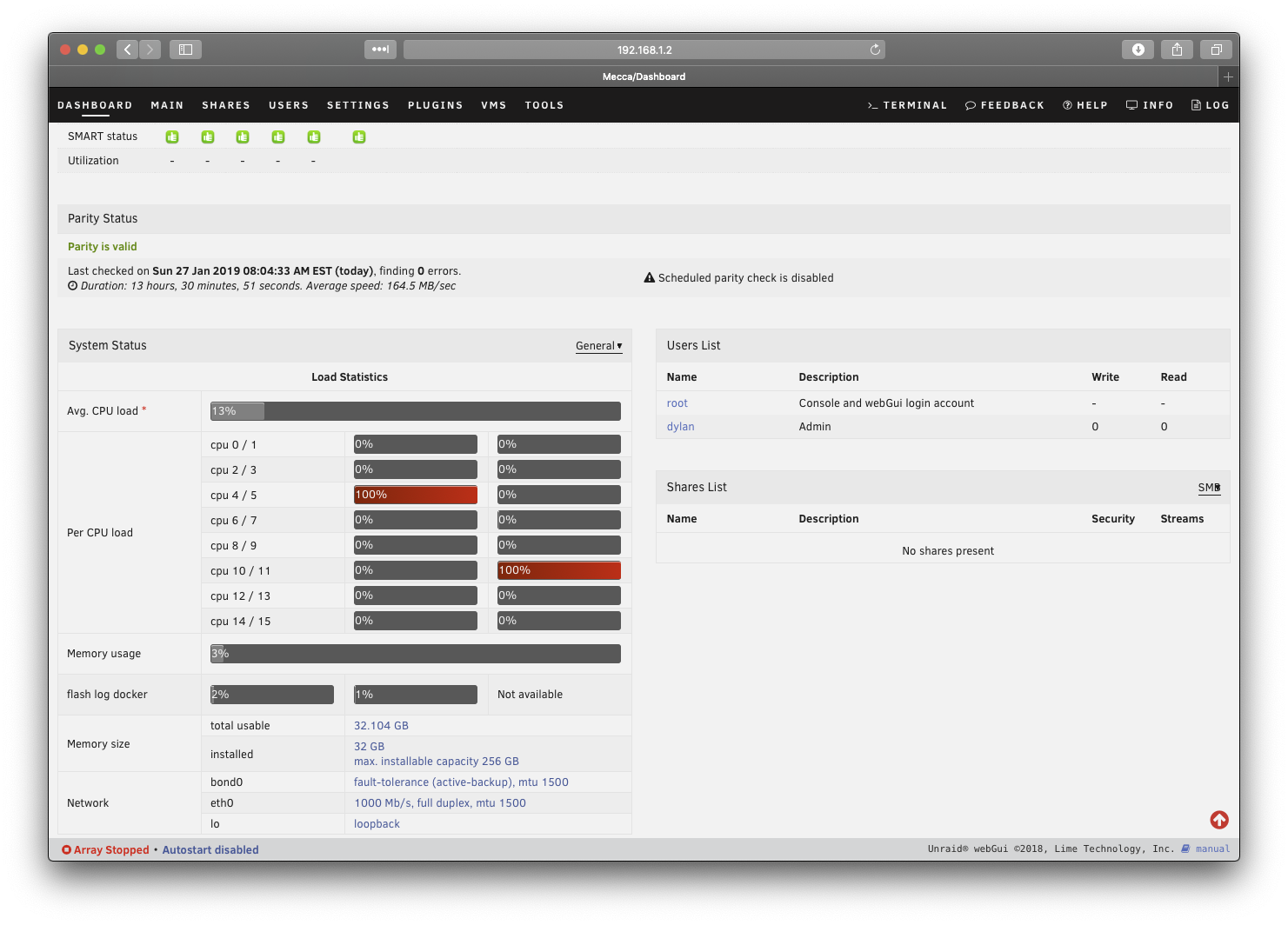

There is also a weird anomaly that I have seen through all of this. Two of the logical cores on my CPU are pinned at 100% oddly enough. I am not too sure if that’s related or not, but I just thought I would mentioned it.
