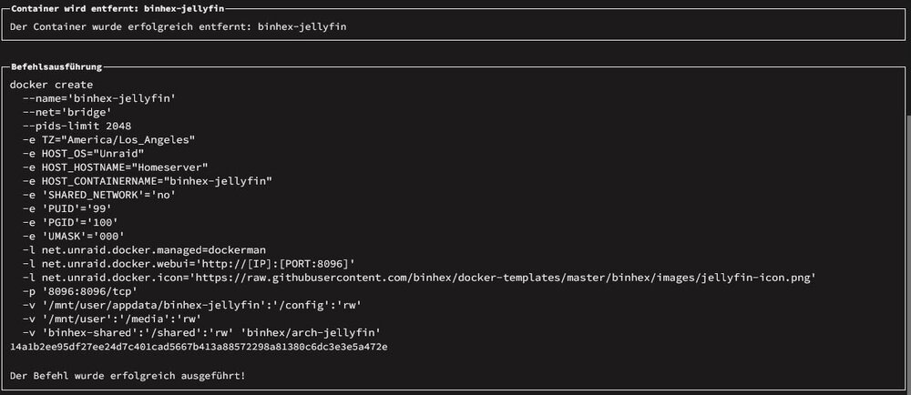

by default jellyfin settings and metadata is not being saved after container restarts.  cant find the settings in jellyfin to remap the directories to /config .
7 hours ago, greyv said:
this is great thanks.
That doesn't sound correct. A restart doesn't delete anything. You should post your docker run command.
It seems that jellyfin saves files in a /tmp directory not /config. So changing that parameter in the docker file should fix it

Run command (formatted)
root@localhost:# /usr/local/emhttp/plugins/dynamix.docker.manager/scripts/docker run -d
--name='binhex-jellyfin'
--net='br0'
--ip='192.168.1.212'
-e TZ="Australia/Perth"
-e HOST_OS="Unraid"
-e 'TCP_PORT_8096'='8096'
-e 'UMASK'='000'
-e 'PUID'='99'
-e 'PGID'='100'
-v '/mnt/disks/downloads/_temp/emby-test/media/':'/media':'rw'
-v '/mnt/disks/downloads/_temp/emby-test/tv/':'/media-tv':'rw,slave'
-v '/mnt/disks/downloads/_temp/emby-test/movies/':'/media-movies':'rw,slave'
-v '/mnt/disks/downloads/_temp/emby-test/music/':'/media-music':'rw,slave'
-v '/mnt/user/appdata/binhex-jellyfin':'/config':'rw'
'binhex/arch-jellyfin'
c727eb966e562c0f8c20a88bbdc36eada63cd79edbdf53b9d29303c9c9602138

sorry guys my screw up, forgot to change path for jellyfin data env var, its fixed now and is building a new image, sadly this will of course mean that when you pull the new image down it will re-create the container and thus you will looose any config (as its currently incorrectly located in the container).
