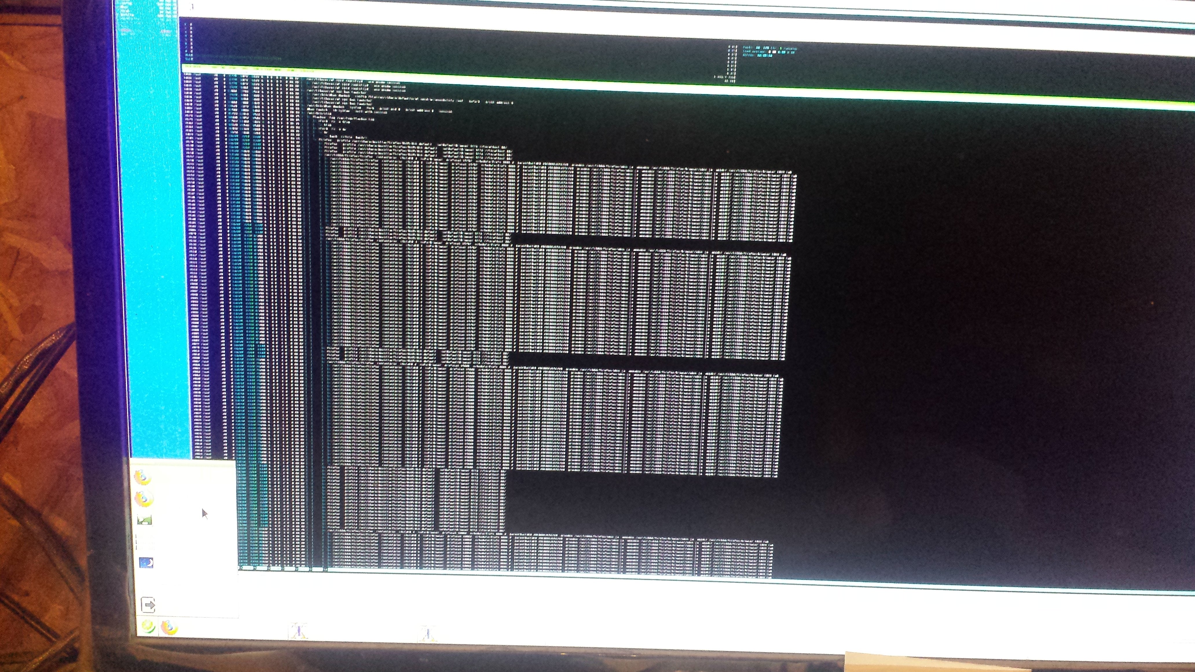

there is options  like Start Button when i click it the text is microscopic..  like its 1pt  size
unraid is working on my Asus Crosshair IV board as my Nas Server    but i cant get Unraid  to detect the onboard nic on my Asus Maxmimus Hero VIII board.. any suggestions
here you can see the tiny text

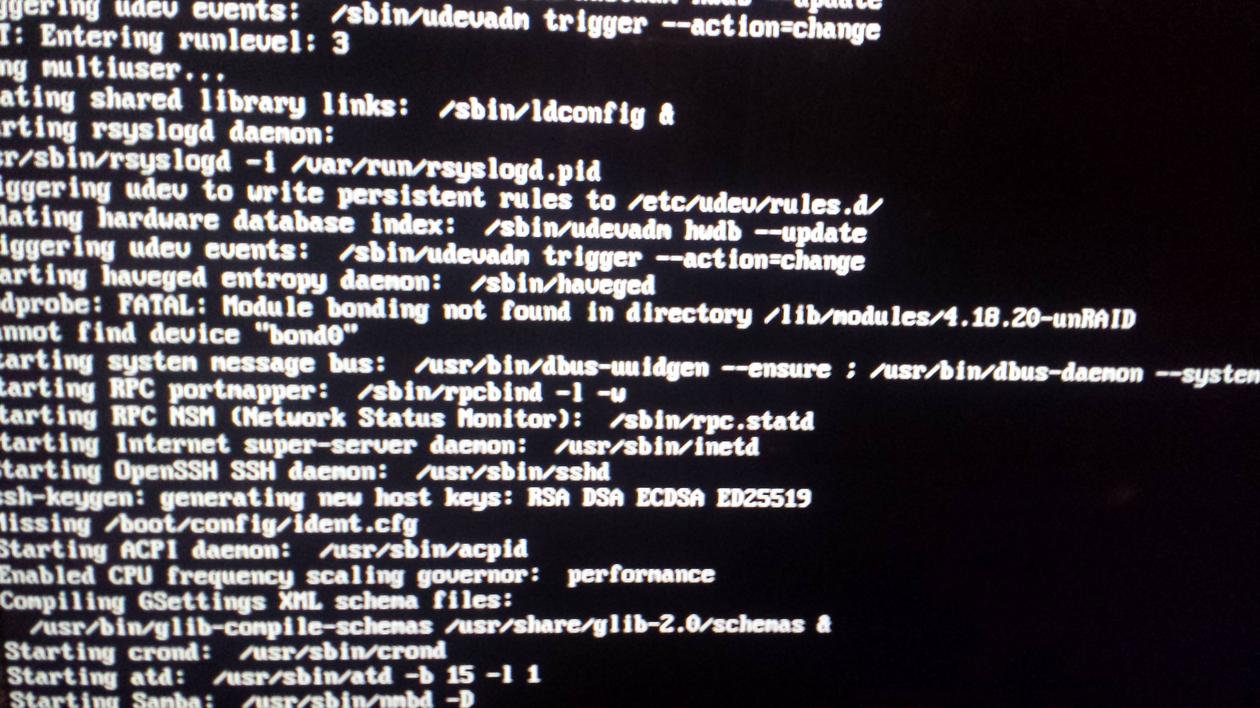

also seen this error  modprobe fatal error.. also its version 6.6.6
That can happen if the flash drive is not being mounted correctly during the boot process.

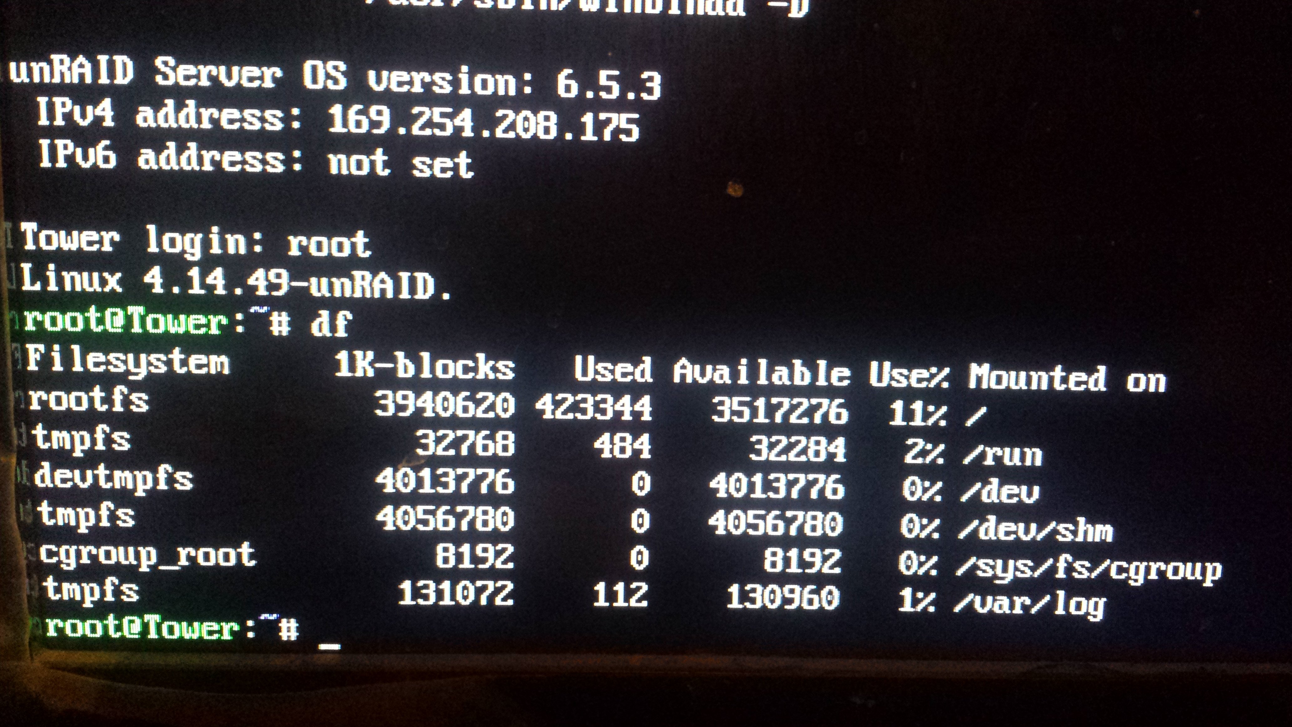

can you log in at the console?   If so you can try the ‘df’ command to see is there is a /boot device mounted (which is where the flash drive gets mounted).
i can do the console you see above with the tiny printing  that is  unraid Gui mode  and i tried Unraid Safe mode gui    and also tinny
so i cant tell what to click  the start button and the 4 or 5 options all  microscoptic    as you can see in first pic
i thought maybe it was 6.6.6   but i tried  6.6.5  and 6.5.3  an still doing same fatal error
and i tried  DHCP  and Static  no difference..  i also tried  Installing by Zip file  manual  and still cant get an IP

those tasks when you click start button still microscoptic

so im able to get the gui  through my laptop to work  for the 2nd usb stick  still cant use the gui when i choose  unraid gui option...  and the start button options and screen is microscoptic is there a way to fix that why does that happen..
