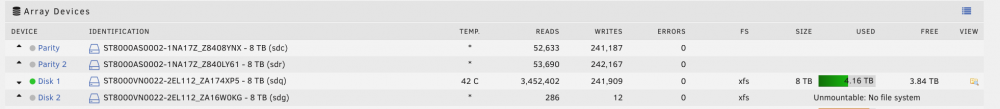

Today when I started the array (rebooted to try the 6.7.0rc2 from 6.6.6; think if anything is wrong it was the reboot, not the new version that caused this) I see this:
1400701792_ScreenShot2019-01-29at5_24_15PM.thumb.png.9e37e9db7cf780b55f818d436cc01f82.png
If I do `ls /mnt/` I see all my discs except for `disk2` which is just missing.
- Does this mean my array is emulating disc2 via parity, or is it out and I'm going to find out once I go to watch a movie to find it's randomly not there?
- Is this a disc issue, or filesystem issue?
... I used to deal with things like this all the time when I was on reiserfs, but in the last few years I've forgotten what this is like! 😛
