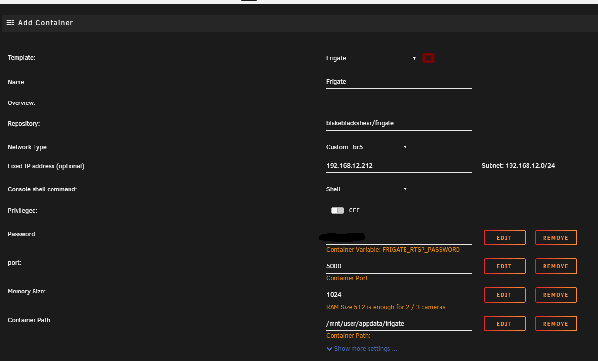

2 minutes ago, karldonteljames said:
Thanks i think I've got most of the settings down:
just not sure what this should be:
I seem to be getting this error when i click apply:
/usr/bin/docker: Error response from daemon: invalid volume specification: '/mnt/user/appdata/frigate:config:ro': invalid mount config for type "bind": invalid mount path: 'config' mount path must be absolute.
See '/usr/bin/docker run --help'.
The command failed.
/config
5 minutes ago, dee31797 said:
/config
Thanks that got it started, I con't have the option for webui, but i can type that in manually i suppose. Now i have the following issue in the log.
File "/opt/frigate/frigate/video.py", line 131, in __init__
self.regions = self.config['regions']
KeyError: 'regions'
Thank you for your help. I really appreciate it.
KeyError: 'regions'
no problem!

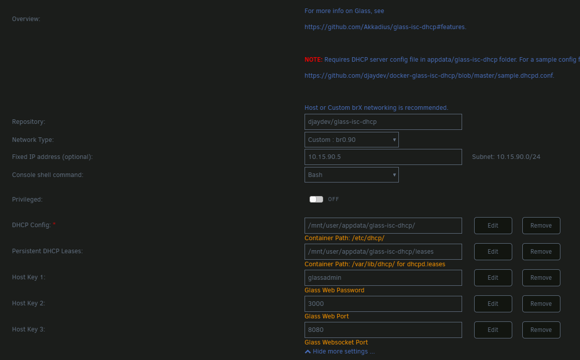

I'm having an issue getting the dhcpd / isc-dhcp-server service to start in the dhcp docker.  I have created a dhcpd.conf file and put it in the appropriate directory.  Any help is appreciated.
I'd like to help but I need information to do so.  Can you post your settings for the dhcp docker?
The command failed.
You need to give the full path (one starting with a /) for the config path inside the container as otherwise docker does not know how to do the mapping.    I would also expect you to want read-write access rather then read-only so the container can update config information but that depends on the container requirements.   I would also update the description to be the path inside the container rather than the UnRAID level path although strictly speaking that is purely a cosmetic change.
Settings are mainly default except for the IP address/bridge.
I haven't tried this with macvlan networking recently, but I'm pretty sure it works.
Can you send me the docker container logs as well as the dhcpd.conf file?
Edited by dee31797
correct config file name
I certainly can. I will DM you with them.

Posting the issue/resolution:
Looks like I was missing a required declaration for the subnet in which the containers network interface resided.  The service wouldnt start without this.  Adding this subnet (even without a range/pool assigned) allowed the service to start and begin responding to DHCP Discover and dhcp requests on the configured subnets in the dhcpd.conf file.

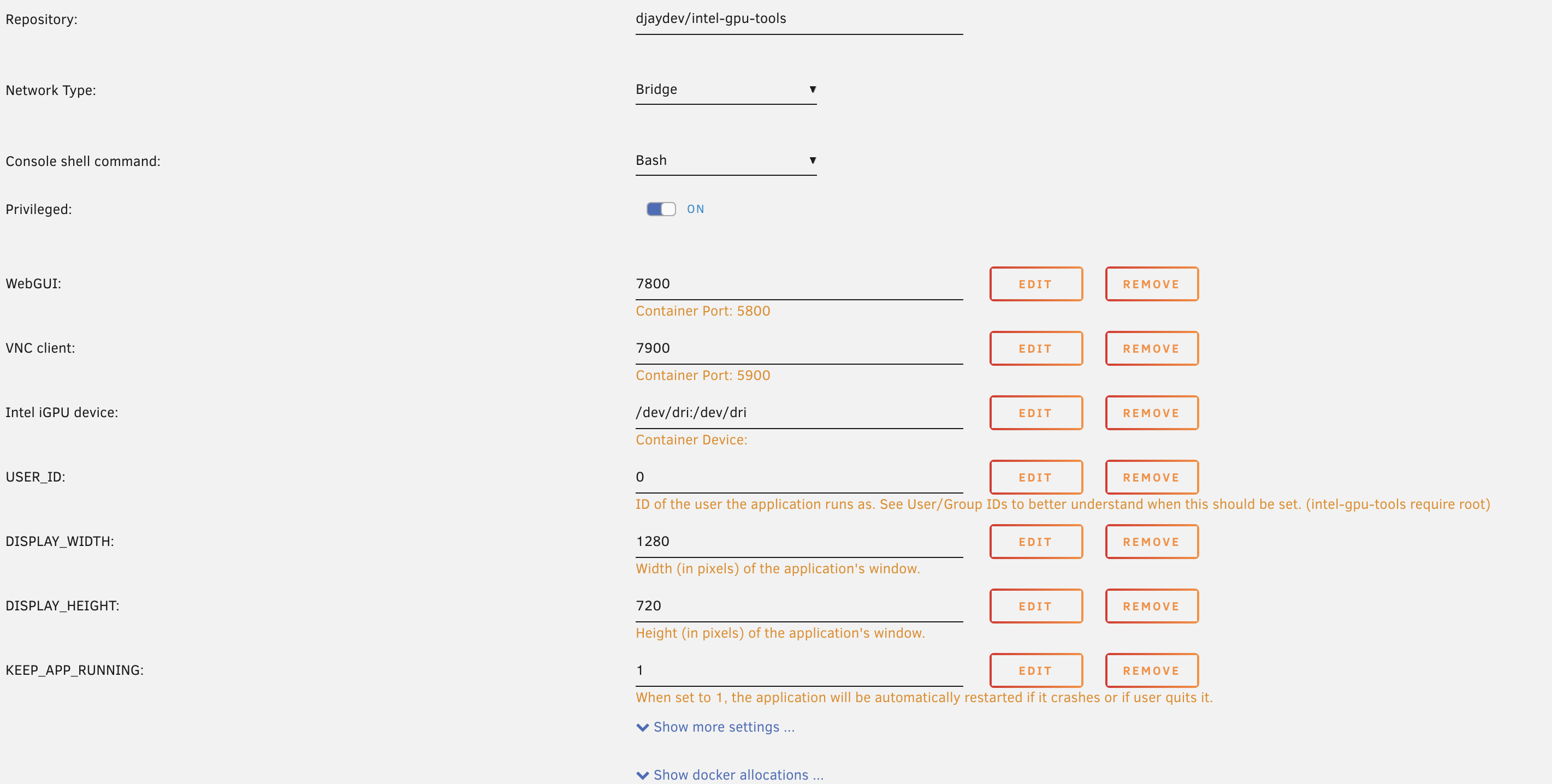

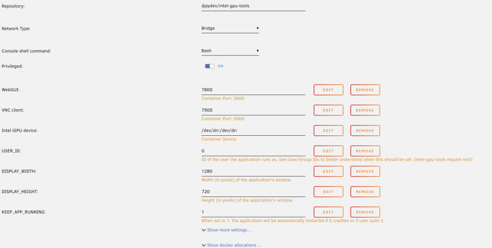

Hi I've installed the djaydev/intel-gpu-tools docker. VNC doesn't seem to work and the console is just blank.
Here are my settings:
1502512350_Screenshot2020-05-07at09_00_35.thumb.png.0058cc15b83728d92825f385a7d44260.png
Please post the logs.
The webui from your settings is port 7800, so goto http://yourunraidip:7800

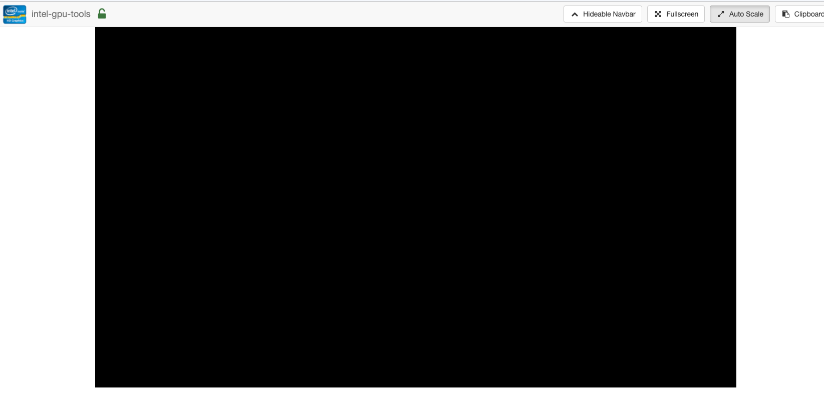

Thanks,
Where do I get the logs from?
The webui just shows a blank screen....
580697403_Screenshot2020-05-07at14_05_37.thumb.png.c5713ed1e030eb3e7cfecf8a4dd85ba8.png
2 minutes ago, parisv said:
Thanks,
logs: go to unraid dashboard, click docker icon, click logs

[app] starting intel-gpu-tools...
The app can't find the GPU for some reason.
Goto the unraid cli console, type
ls -la /dev/dri
post the output here
ls -la /dev/dri
root@tower:~# ls -la /dev/dri
/bin/ls: cannot access '/dev/dri': No such file or directory
root@tower:~#
that's odd I added this to my go file yesterday to help h/w transcode for plex.
#!/bin/bash
# Start the Management Utility
/usr/local/sbin/emhttp &
modprobe i915
chmod -R 777 /dev/dri
