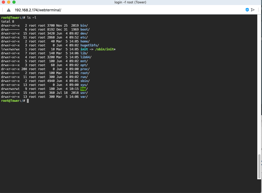

root@tower:~# ls -la /dev/dri
/bin/ls: cannot access '/dev/dri': No such file or directory
root@tower:~#
that's odd I added this to my go file yesterday to help h/w transcode for plex.
#!/bin/bash
# Start the Management Utility
/usr/local/sbin/emhttp &
modprobe i915
chmod -R 777 /dev/dri
Until that's working this docker will be blank/black screen.
Ok I've figured it out. My motherboard had the gpu when a monitor was attached but since moving it to the cupboard and making it headless it wasn't enabled. I changed the settings int he bios and can now see:
root@tower:/dev/dri# ls
by-path/  card0  renderD128
and gpu tools is now working thanks.
Edited by parisv
32 minutes ago, parisv said:
thanks, at least I know where to look now. Is there any issue with what's in my go file?
That's the same as my go file.  What processor are you using?  Also, the igpu has to be turned on in bios.  Lots of variables to get igpu working in Unraid and this thread isn't the best place to figure it, I just put together the intel-tools container.

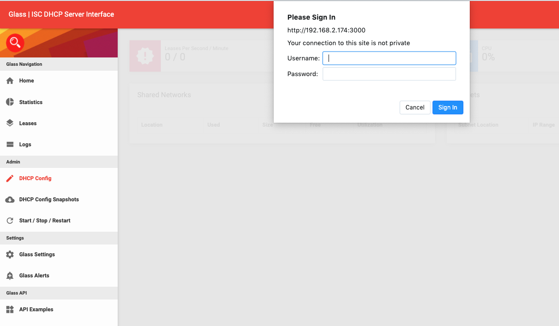

Hi to everyone, I am trying to set up a video surveilance server with shinobi over Unraid.
The thing is, that I want to use 2 separate NICS, one to access the cameras and the other to connect Unraid to my home network. I have, finally, made Shinobi work, but I'm still having issues with the cameras. Since I don´t want to use them with fixed IP adresses, but rather with DHCP adresses assigned from the UNRAID server.
So, I start glasss-isc-dhcp and after a couple of minutes it stops. That is one thing, the other is that I can not even edit the DHCP config at the GUI, because it asks me for a username and password because my connection its not private.
Here is the screen shot:
691752536_ScreenShot2020-06-04at11_19_54AM.thumb.png.31076e41d9cef72aacb3b9f8a59a77c9.png
And if I try to use "glassadmin" and "glasspassword" It wouldn't recognize them. And after a couple of minutes the Glass stops responding so it does not mater what you type in, the system turns useless anyway. So it is two issues in one.
I don't know if it is a problem when the databases are crated at the moment of the installation. So, if the database is not installed correctly, there will be no reference data to compare the user and the password I am typing to the one that should be stored in the database.
I am thinking that the login problem is a result of the database one, fixing the database problem should solve the login problem.
Here is a copy of my log, I hope that you can help me understand what is going on so I can solve this issue.
Thanks a lot.
Cheers!
ISC DHCP GLASS Log.txt

I believe the issue that causes it to shutdown is the missing dhcp configuration file, log message "dhcpd-pools: parse_config: /etc/dhcp/dhcpd.conf: No such file or directory"
WIthout this file the DHCP server will not start as well as glass admin.  For a sample config file, see www.github.com/djaydev/docker-glass-isc-dhcp/blob/master/sample.dhcpd.conf

Thanks! I've seen those instructions, and I tried to do it, however, the ISC-DHCP-Glass terminal also becomes unavailable and I can not reach those directories.
Is there a way to reach them outside docker?
Thanks!

Yes, the directory exists on your machine, you access them however you wish.  The docker container only sees them as a mapped volume.  If not mapped from your machine to the docker container, then they don't exist.
Thanks, would you mind telling me where to start?
This is what I see from my root directory in unraid. Sorry I'm not very experienced with linux,  I understand a little bit.
Thanks!

I can help with the file system, but you're going to have a tough time with this container.  It's an advanced setup running a web server, dhcp server, text based configuration via config files.
The docker container settings (in Unraid GUI) has a list of volumes, variables, devices, etc and are managed by you.  In this specific instance you need to add "/etc/dhcp/dhcpd.conf" to the docker container.  The most common why this is done is with an appdata folder, "/mnt/user/appdata/glasss-isc-dhcp/dhcpd.conf" mapped to "/etc/dhcp/dhcpd.conf", but the choice is yours use whatever host directory you desire.
Once your selection is made, use the Unraid GUI docker settings to change the host path to your selection and the container path should already be filled in when you installed the container.  For an more in depth explanation on docker settings and volumes please see https://wiki.unraid.net/UnRAID_6/Docker_Management
