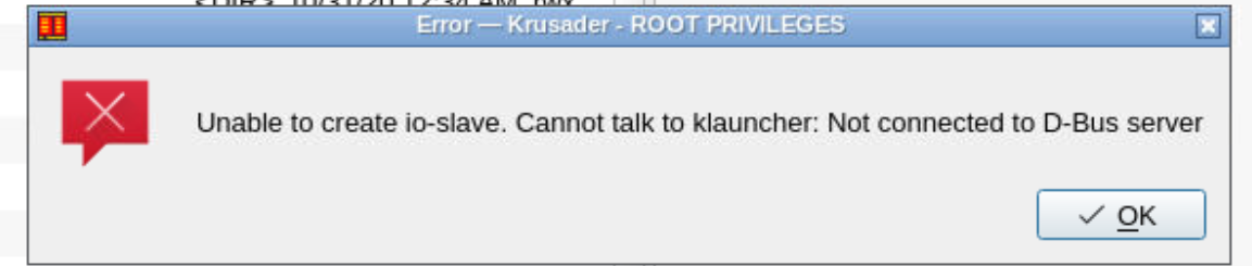

what does this error mean  when I trying to move files off a NTFS unassigned drive in krusader  not bin krusader
I never seen that error but I believe it's a permissions issue. Hard to troubleshoot but check the user id Krusader is setup with (USER_ID=) and that user has permissions to both source and destination.
@dee31797
my user and group I have set to 0 0  since I had issues with the default settings..  I use the default setup  from the krusader setup
and not sure what the sourcen and desitination permissions are?
if you mean the drive   …  Source was Unnassigned NTFS drive   Destination was the Unraid Array
9 minutes ago, comet424 said:
@dee31797
I think the user/group 0/0 should fix any permissions problems, but to verify I would try it from Unraid's CLI.
touch /mnt/disks/{yourNTFSmounted-drive}/testfile.txt
cp /mnt/disks/{yourNTFSmounted-drive}/testfile.txt /mnt/user/{unraid-share}/testfile.txt
if possible try to use the exact same folders on the ntfs and unraid shares that failed in Krusader.  If that works, it's most likely an issue with Krusader.

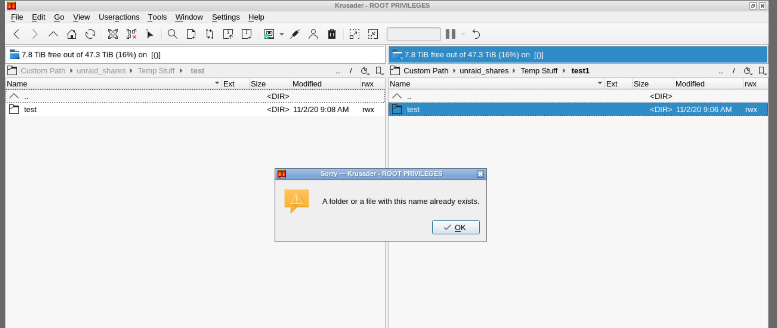

oh ok  CLI  does that mean command line interface?  so from the terminal
ya I get the write into...  sometimes I wont get it and it will say  something like  folder already exisits  so it wont let you write into
but here is a pic where you see you cant move the Same Folder name   where if it was windows I could  I cant move  contents of TEST into Test folder  2 different locations...    reason then I just scrap  krusader and use Windows   but when windows doesn't allow it I use Krusader
I have used the bin-krusader and it seemed buggy  compared to Krusader   so I scrapped using Bin one...  and went with this one as it worked better...

been bugging me for a while.. and cant find it in the settings
how do you resize Krusader.. to full screen.. all the tab Full screen does is make the browser full screen.. so i still have same size Krusader yet bigger gray area.. how can i fill krusader 200 % the size it is say.
