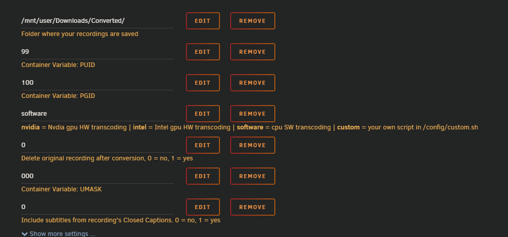

I am trying to use the Recordings-Converter tool. What are the commands to interact with it, since there is no gui?
as soon as you start the container it watches the /watch folder for .ts files and coverts them.  There's really no user interaction.  The settings are applied through environment variables in the template such as subtitles, hardware or software encoding, delete .ts after conversion, etc.
If you want to use a customize convert script save it in the /config folder as " custom.sh " and the container will execute it once it finds a .ts.

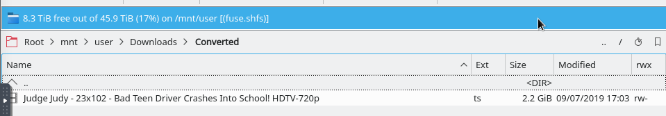

failed_conversions
4 minutes ago, mihcox said:
Hi mihcox,
Your container settings look correct, and I see the file is definitely a .ts.  Sorry that didn't work for you.
Check and see if there's a log file in your appdata /recordings-converter/log folder, the name of the log file should start with "postProcess".  If they are there attach them here and I check what went wrong.
