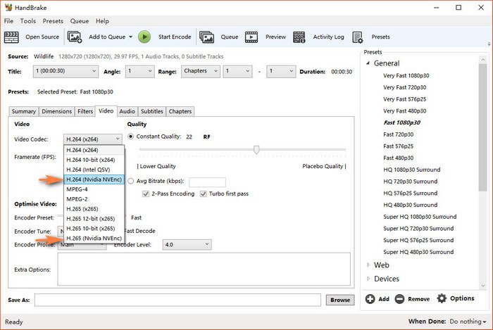

5 minutes ago, ProphetSe7en said:
Thanks!
Your XML looks good, and it works with other containers so that means you have the drivers installed.
When you access the GUI, do you have the options in the pic below?
Yes it looks that way. I am trying one more time to see if it uses gpu or only cpu.
I noticed that when I choose the Nvidia NVEnc the Extra Options is removed. I was told to use "ref=5:bframes=5" in Extra Options for best quality, so now I am wondering if using GPU will give worse quality since I cant use the Extra Options?
There's a lot of debate on the internet about nvenc vs software encoding and video quality.  The consensus I find is that software encoding is better quality, but I personally don't notice much of a difference.
I don't know what "ref=5" does, but "bframes" is not supported by NVENC for HEVC except for RTX cards.  You can reference which Nvidia cards support B-frames here: https://developer.nvidia.com/video-encode-decode-gpu-support-matrix
I am using a GeForce GTX 1060 Pascal GP106.
Using GPU is so much faster than using software at my system, so it is working now :) I will try software and gpu encoding for the first movie just to compare them to see if I notice any difference.
