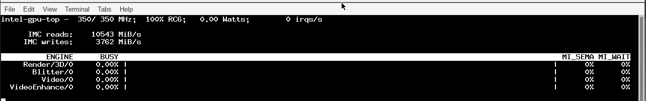

 By a chance do you know how to tell if the IGPU is transcoding. Also you were right earlier. I need to go to 6.8.X for transcoding on 9th gen intel.
3 minutes ago, scubieman said:
Dee,

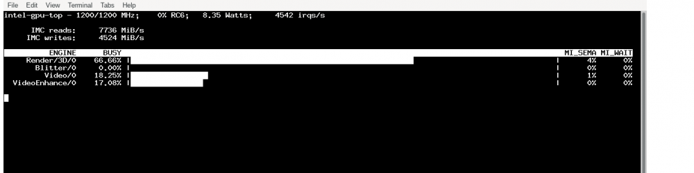

To tell if the iGPU is in use for transcoding or anything else I use Intel-GPU-Tools. You can find it in CA Apps.
I'm assuming its not being used?
Yes that display is only real-time, so right at that moment of the screenshot the iGPU wasn't in use.
Add a .ts file to the watch folder, and within 15 secs you should see bars move left to right to show percent of utilization.  If there's a .ts file already in there, go to the /config folder and delete the file "failed_conversions".
If not, send me your template for recording-converter and we'll get this figured out.

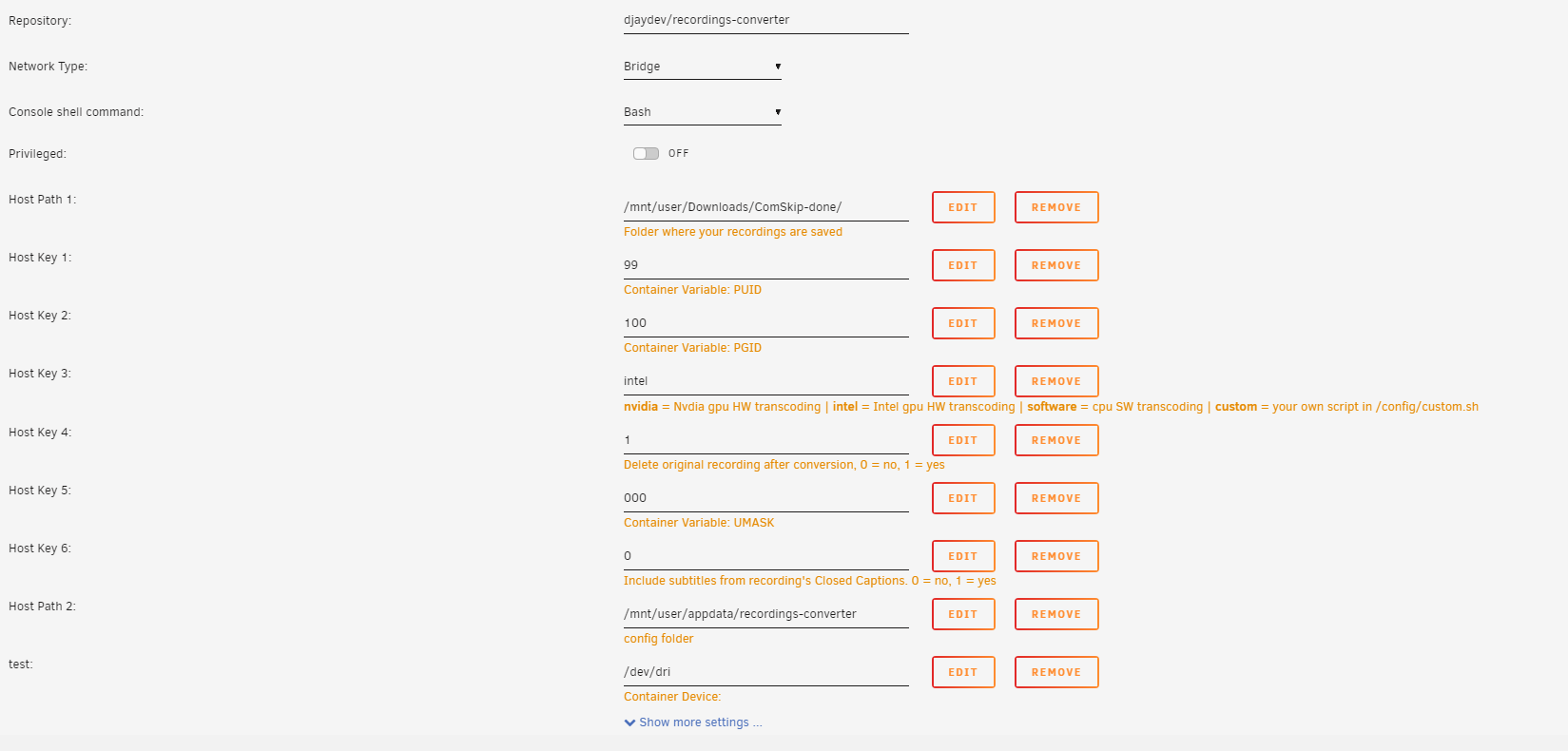

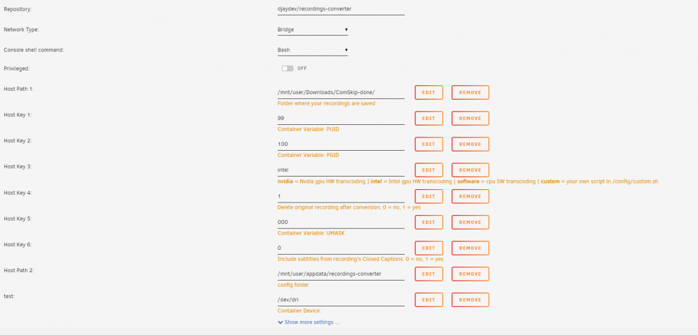

Sadly not working... its the docker enabled, but not picking anything up image.thumb.png.cee9c0a6b347422bd22a1f4e2c8c4cec.png
Edited by scubieman
Thank you.  The template is usually where the issue is but yours looks good.
Within the /mnt/user/appdata/recordings-converter/log folder there should be some postProccessXXX.log files, please send me the most recent 1 or 2 if they are there.  Lastly, the container logs will be useful.  You can get them from the docker tab in the Unraid UI using the paper icon on the far right, or by CLI using "docker logs recordings-converter".

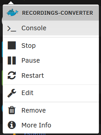

Left click the docker icon to get the menu below for console and container restart
