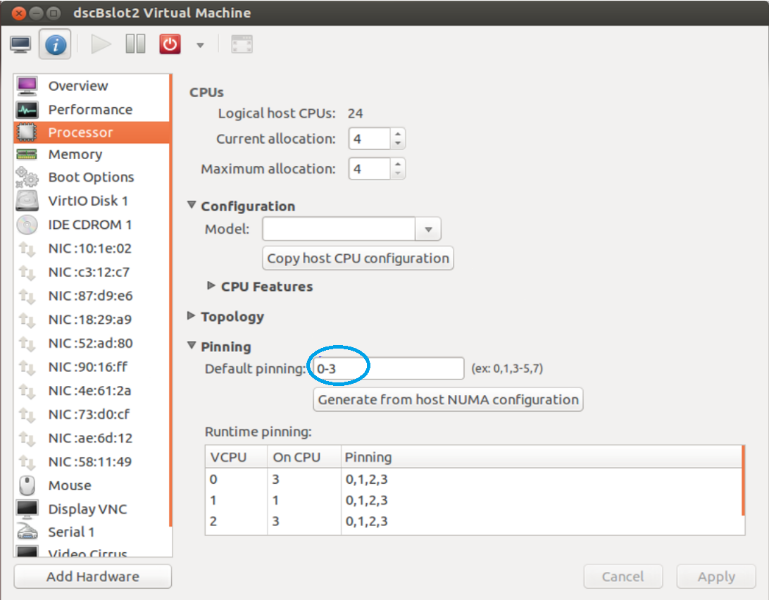

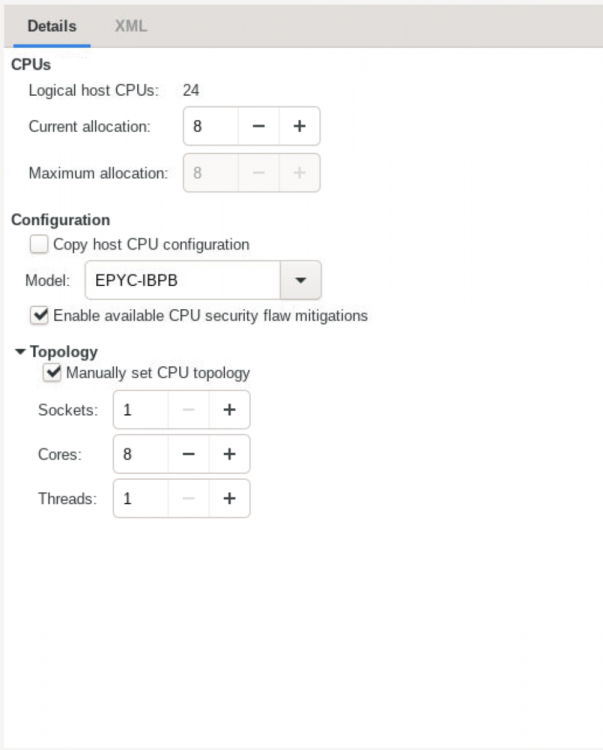

I see a way to assign a "current allocation" and "maximum allocation" of logical cores, as well as manually setting CPU topology, but nowhere do I see where to actually just set which logical cores are assigned to the VM. Am I missing something? I've seen screenshots of virt-manager that include this functionality.
What I see in the docker:

4 minutes ago, GameKing505 said:
In Virt-Manager I don't see a way to modify which logical cores are assigned to a VM (like in the native unraid UI).
What I've seen of Virt-Manager elsewhere:
I believe that's virt-manager running natively on the host instead of in docker
So there's no way to achieve CPU pinning using the virt-manager docker? That's disappointing... I thought the whole idea was that you got /more/ control than the default unraid GUI for VMs.

I use Virt-Manager to have more control than the default unraid GUI.  CPU pinning would be the /same/ control as the default unraid GUI.  You can access this control in Unraid using Settings -> CPU pinning.

From what I can find using virt-manager remotely from docker like this won't give the option for CPU pinning.
