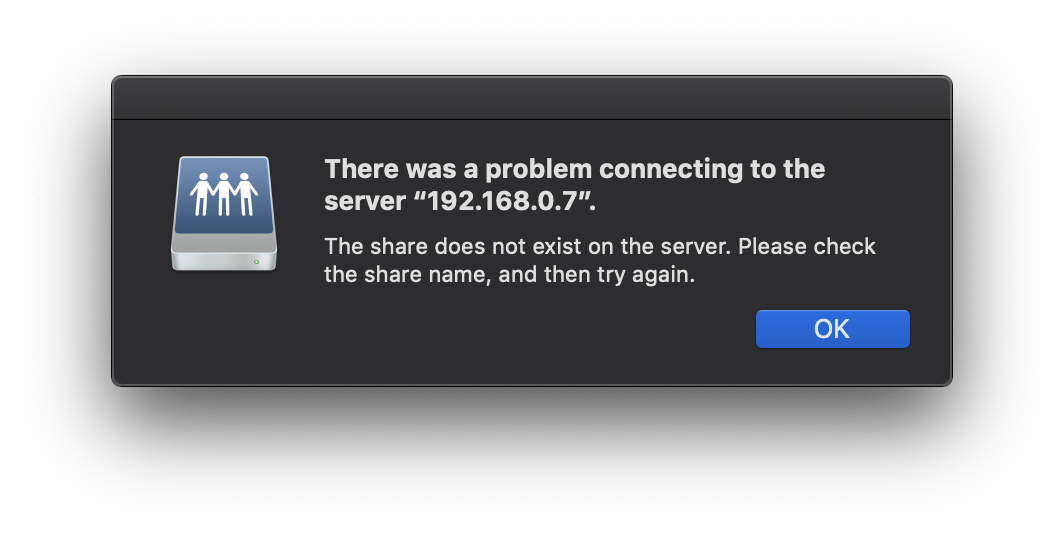

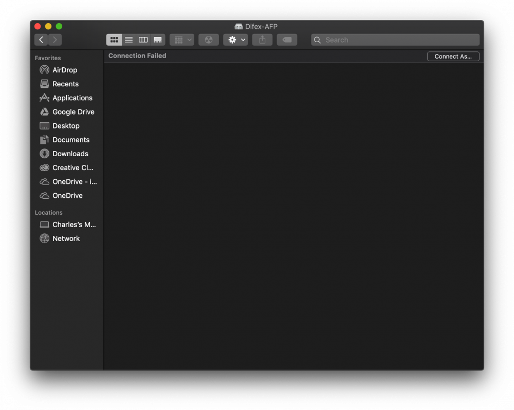

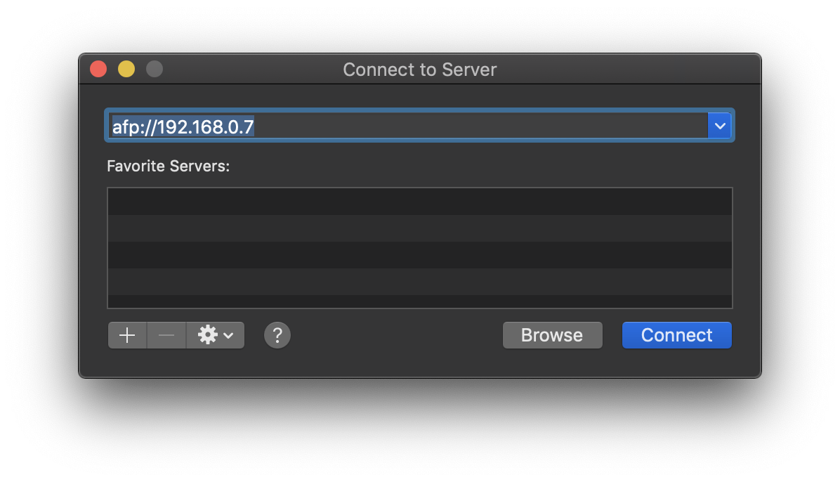

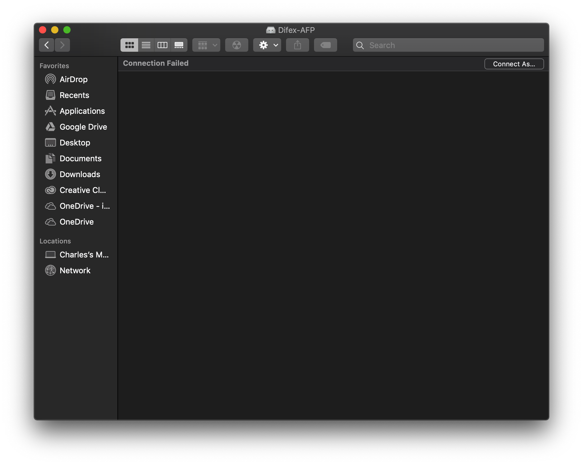

I've enabled AFP, and exported a share publicly. No matter how I connect, it returns an error. Sometimes when I use the connect to server dialog it will ask which share I want to mount but when I try mounting a share, it fails. Just clicking on it in network (to connect as guest) returns connection failed. When I click connect as and specify my password, it still says connection failed. I know AFP is dying but I intend to eventually use it for TimeMachine.
I've included screenshots below. Thanks.
