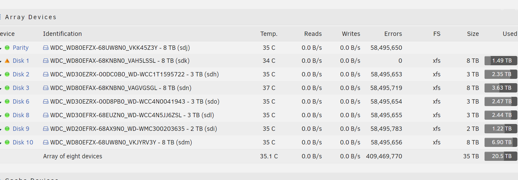

image.thumb.png.65cc9d7de735ee6e001500efa8a6a149.pngCould the controkler be dead?!
The fact that all of them went missing makes me skeptical there is anything wrong with the original disk1. But rebuilding to a new disk is fine and even gives you another option since that original disk can probably be read if there is any problem with the rebuild.

You're having a problem with the HBA:
Feb  2 23:35:52 Knowlage kernel: mpt2sas_cm0: SAS host is non-operational !!!!
Update firmware to latest, you're on FWVersion(18.00.00.00) and latest is 20.00.07.00, also try a different slot if available, if still issues after that it could be a failing (or fake) HBA or some compatibility issue with your board if this is a new config.
