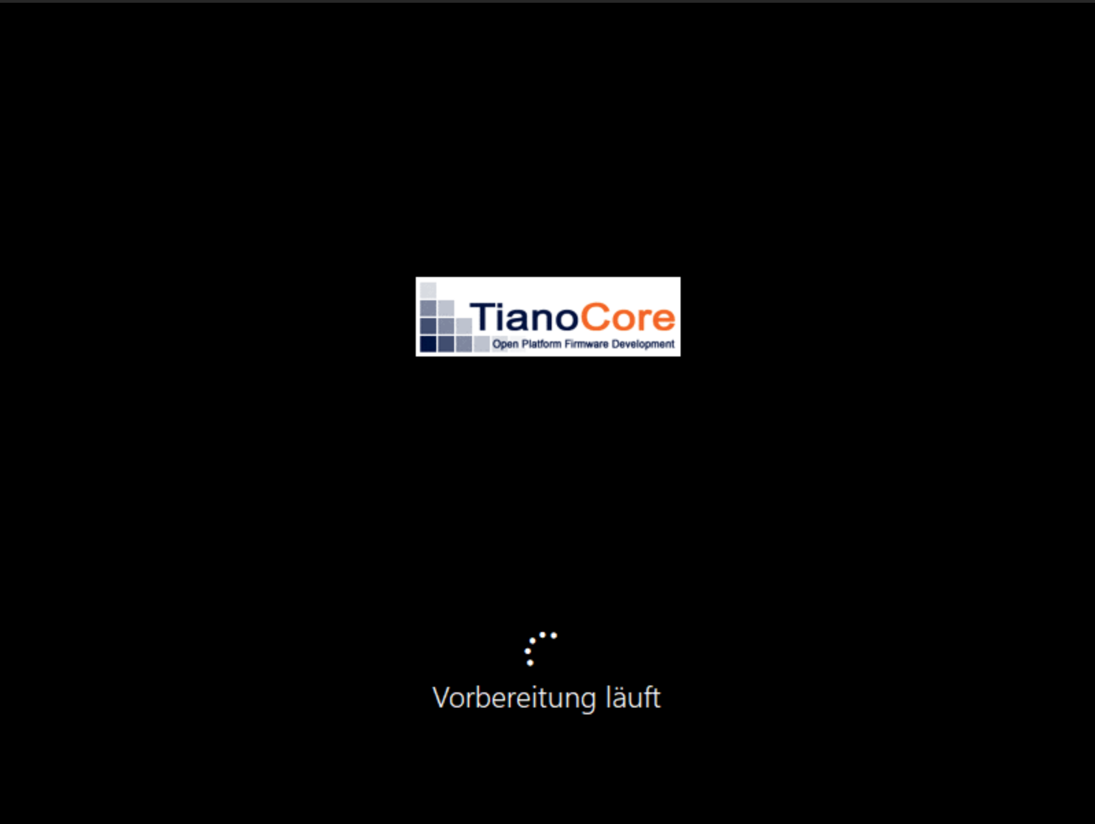

First I thought it's still not working, then I created an Q35 machine, which also showed the TianoCore logo after pressing a key but quickly also showed a loading logo and some seconds later I was in the setup menu. I was then curious whether i440fx also works when waiting some time, yes it did! So I'm not sure whether I would have had to wait just a little bit longer before (because I maybe only saw the TianoCore logo instead of windows installation loading), but disabling CSM wasn't a bad idea at all I guess.
EDIT: Even though it looks kind of strange now...
