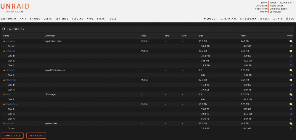

Hello,
thanks for your instruction, I did everything you wrote,
Please kindly find attached the screenshot.
There are still some files on MediaPlex in the cache. I don t know what it cloud be. I checked and in the cache ssd, MediaPlex folder is empty.
I also reboot the server.
Do you know why next to MEDIAPLEX folder there is a triangle who tell me that my files are not protected?
Thanks !!
Best
According to that screenshot, your system share still has files on disk2, so you still need to fix that. I don't know how that got missed. Are you sure the system share is set to cache-prefer? Maybe you missed some steps in my instructions. You will have to repeat them.
If you are writing anything to MediaPlex and it is a cache-yes share then new files for that share will be written to cache and later moved to the array when mover runs, so that seems normal to me.
You should get rid of that 2nd share in the list, the one that is probably the result of a typo and has a similar name to appdata. That is only going to be an opportunity for more mistakes in the future. Just click on that share to get to its page and you should be able to delete it since it is empty.
You might go to Settings - Scheduler - Mover Settings and enable mover logging temporarily so we can see what mover is doing when you post your next diagnostics.

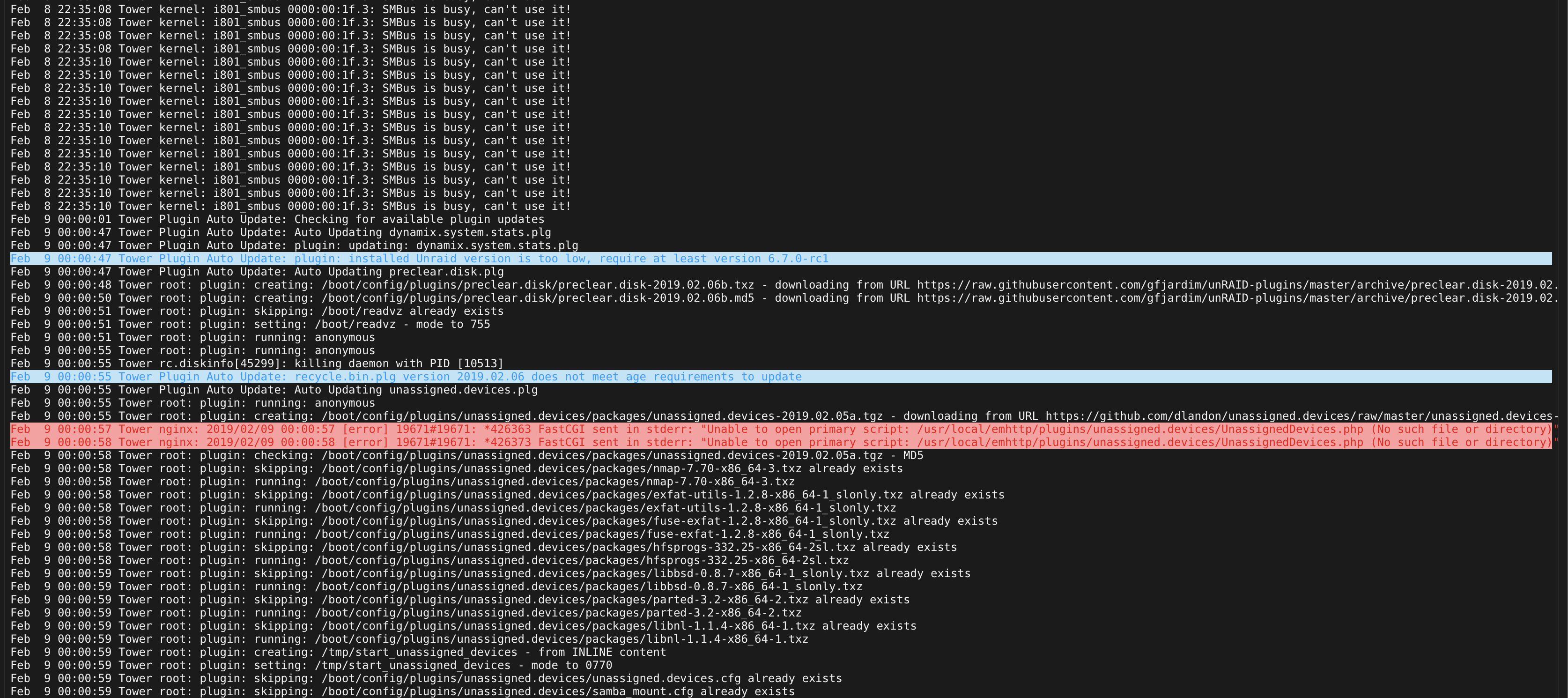

Crash happen at 00h00
tower-syslog-20190209-0017.zip

1 minute ago, Keint said:
I attached the log.
That is just the syslog. We would rather have the diagnostics. Did you try to get the diagnostics?

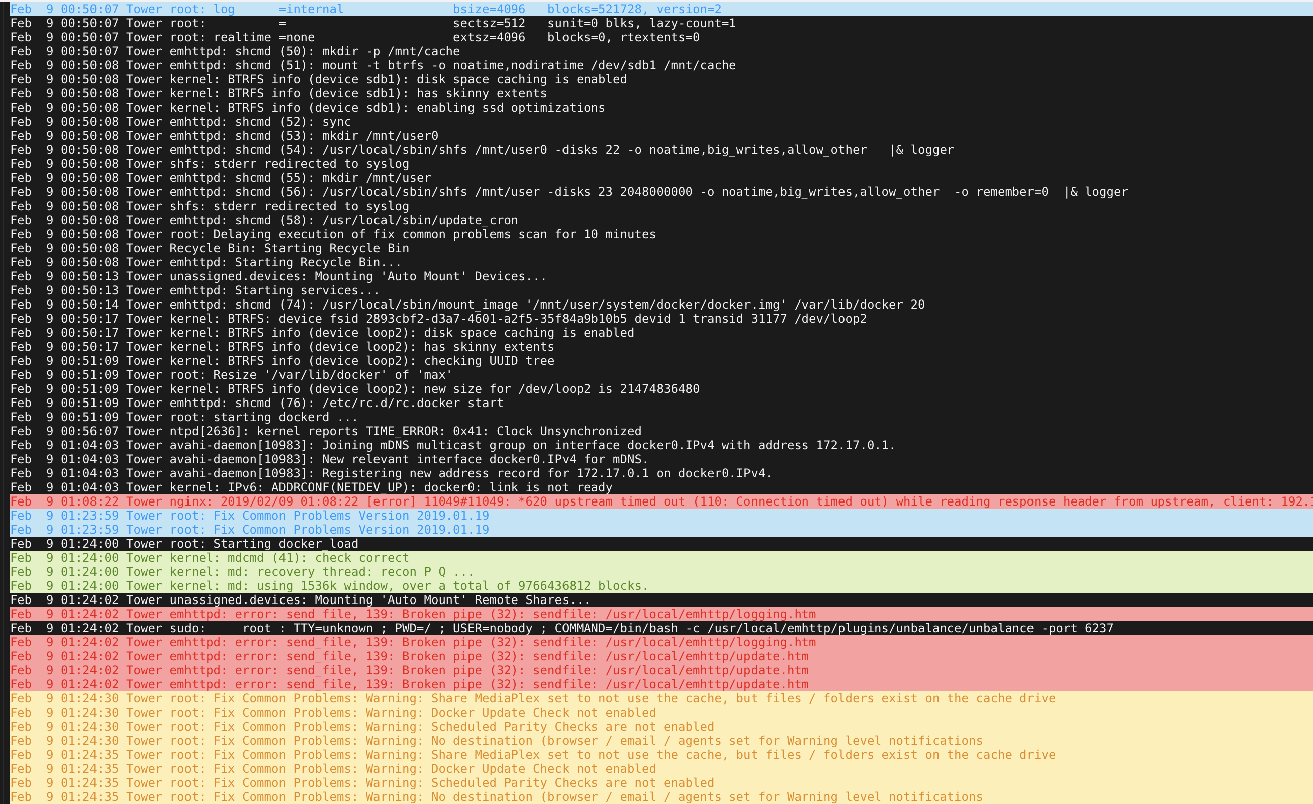

I just did this screenshot before restart
.png
I was creating a parity on two HD when Unraid crashed.
Edited by Keint

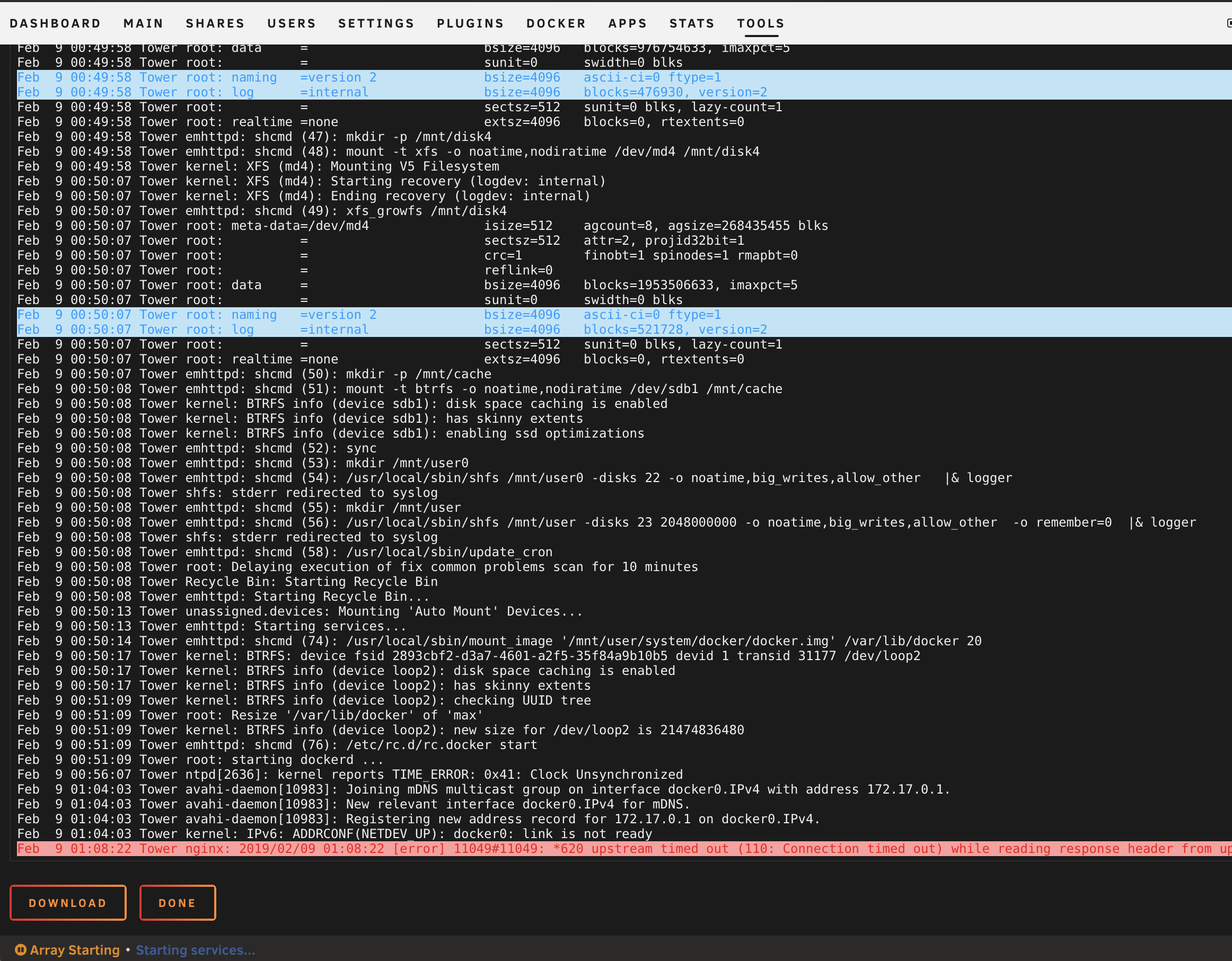

Here we go,
attached the diagnostics
tower-diagnostics-20190209-0053.zip
and actually my Server is stuck on '' Array Starting•Starting services..''' and nothing happen...
Edited by Keint

The syslog you posted was full of these:
Feb  9 00:17:22 Tower kernel: i801_smbus 0000:00:1f.3: SMBus is busy, can't use it!
Google seems to indicate this is related to sensors. Is your BIOS up-to-date? Maybe some problem which is happening when System Temp plugin tries to get the temps. Don't know whether or not it could be related to your crash.
Yes it crashed often, like every 2days. I followed your instruction, and after tha ''mover'' started to work well again.
My bios is running the last updated available. I get this error since ever, I m using a Supermicro test server with engineer sample CPU..
I m still stuck on '' Array Starting•Starting services..''' and nothing happen, do you have any recommendations?
Thanks again for your time !
Edited by Keint

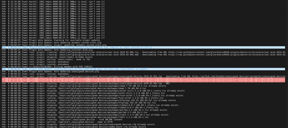

I feel the server crash when is updating  automatically the plugins by ''CA Auto Update Applications''
I ll turn it off to see if it s crash again.
 40 minute after the crash, the array is back. the server is on, dockers start 15 mn after the array was back
Thanks again for you help

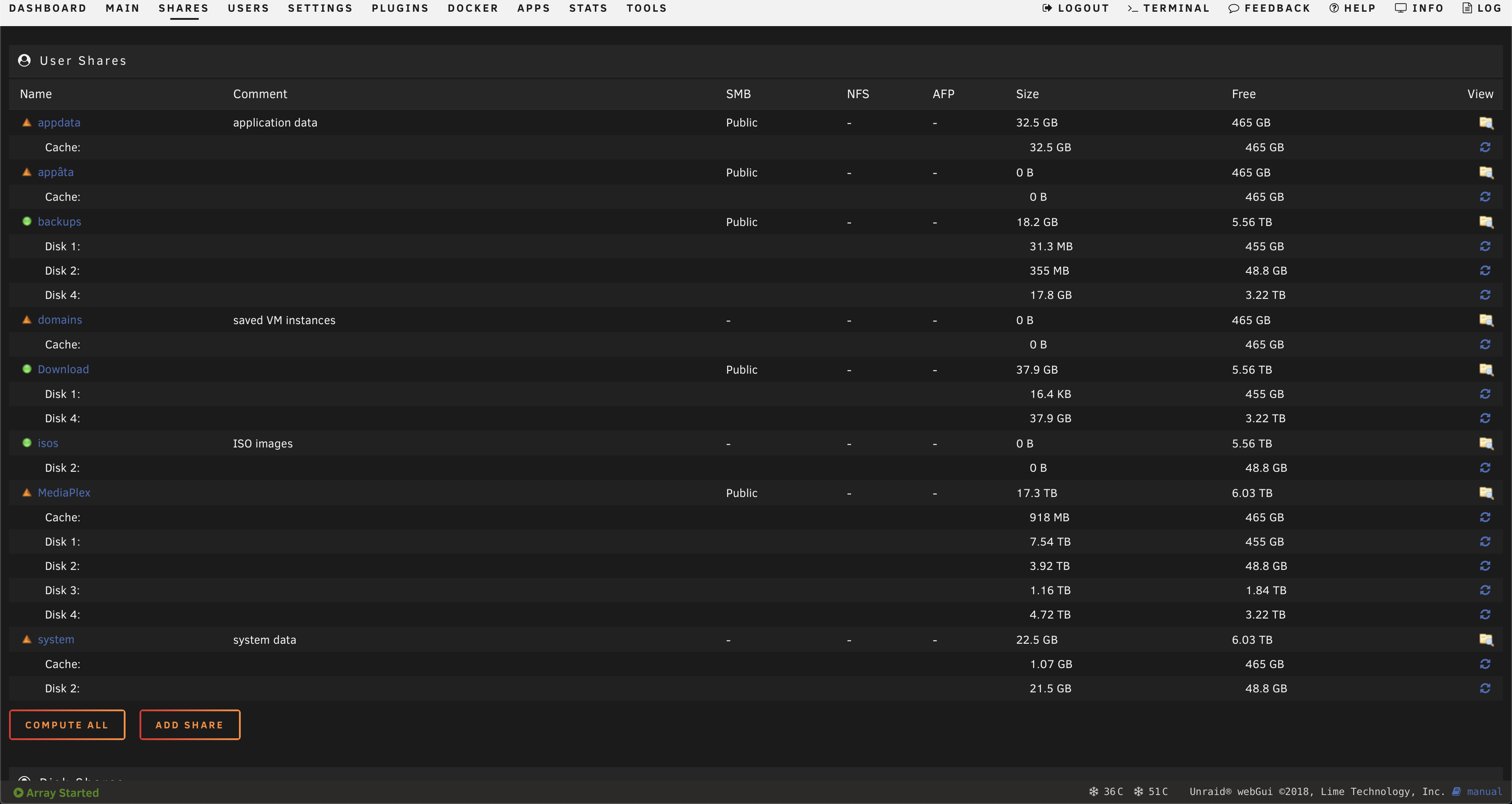

I did follow all you instruction again, please kindly find attached the screenshot.
The cache has only the fils from appdata and system.
The ''service system'' and dockers seems now start normally !
I keep you update if there is any other crash !
Thanks again for your time and your patience!

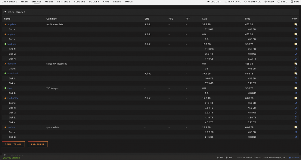

On 2/4/2019 at 10:21 PM, Keint said:
Looks like you're running a little hot too. If you weren't pushing it that hard and your hitting 51 C already, I might be concerned with that. Could be wrong, but it seems a bit high to me.
Hello,
thanks for your message, I think I setup the wrong sensor, 51C is the sensor of the chips I350BB who is the lan chip.  I didn't find which one I the MB sensor ^^
Cheers
