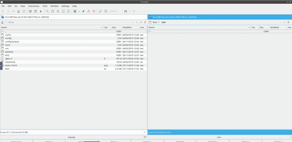

Screenshot of what I'm seeing

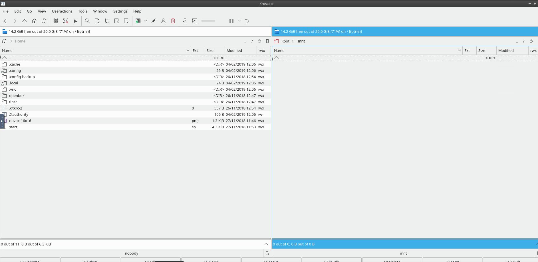

If I follow the path that I had noted in the setup of /root/mnt in Krusader, I get this:
Krusader is running as a docker, which means it's a special kind of virtual machine. It only has access to paths that are mapped to it, all the other paths you are seeing are inside the docker's operating system.
Examine the configuration for the docker, click edit on any path variables, and pay particular attention to the host and container paths. Whatever is populated in the container side is where you can find in Krusader whatever is mapped to the host side of that mapping.

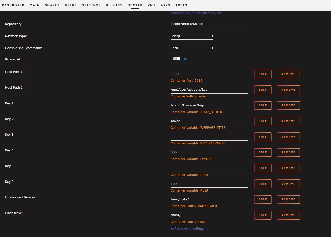

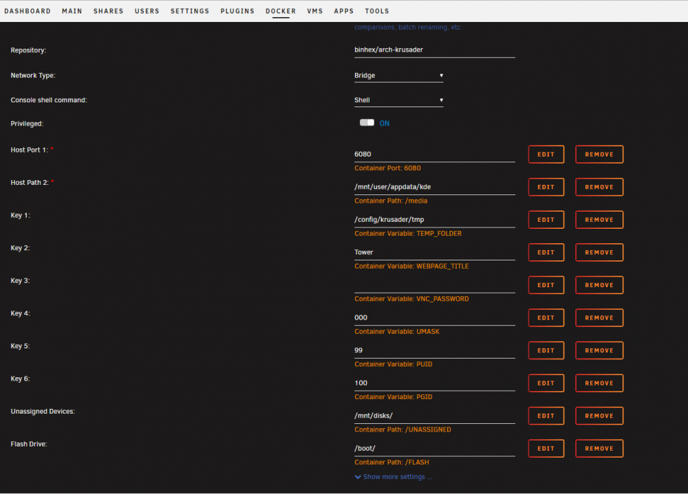

Looking at the docker config, here is what I see:
In the video he references a "Host Path 1" that as you can see from above is non-existent, or invisible to me.
Looking at Krusader, the /UNRAID directory that I'm looking for is not in either host or container side. So I don't understand your response.

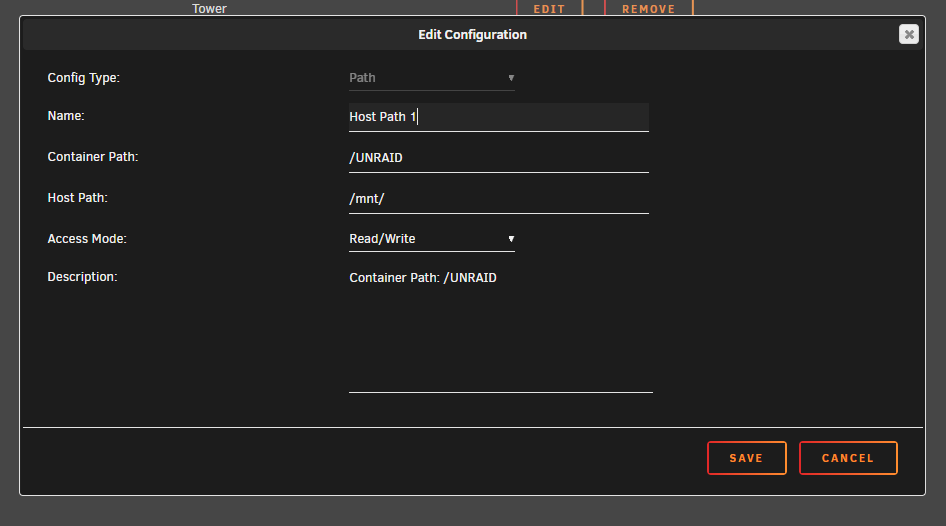

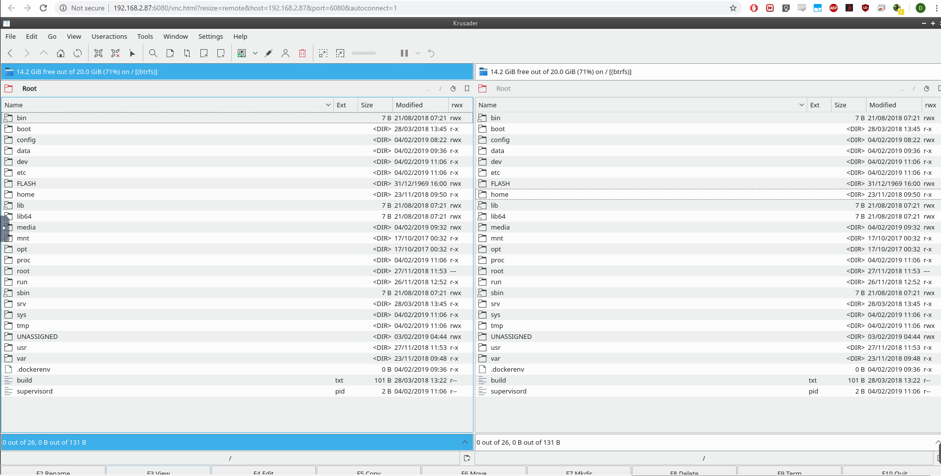

Ok so I just added a path in the Krusader container settings (attached), restarted the container, and that seemed to solve the issue.
2019-02-04 16_05_49-Hydra - TeamViewer - Free license (non-commercial use only).png
Thanks, this worked for me.
