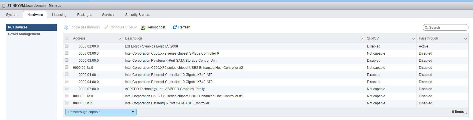

@syee please then post screenshot from ESXi pass-trough page..
Here's a screenshot from the VMWare side

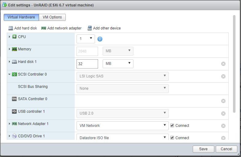

This is from the VM for Unraid side.
Thanks again everyone for your input!
you should add PCI device and choose LSI2008.
Man I feel dumb.   This was the piece I was missing.  Added it and now my disks show up.  Thanks uldise!
