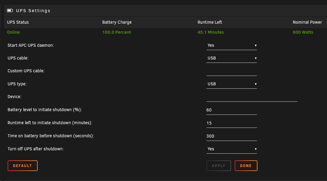

Auto shutdown can be triggered by several milestones as seen below in my unRAID UPS settings.
The server will gracefully shutdown when one of the following (whichever comes first) happens: UPS battery level is at 60%, there is 15 minutes of run time left on battery, the server has been running on battery for 5 minutes (300 seconds).  I also have it set to turn off the UPS after shutdown.

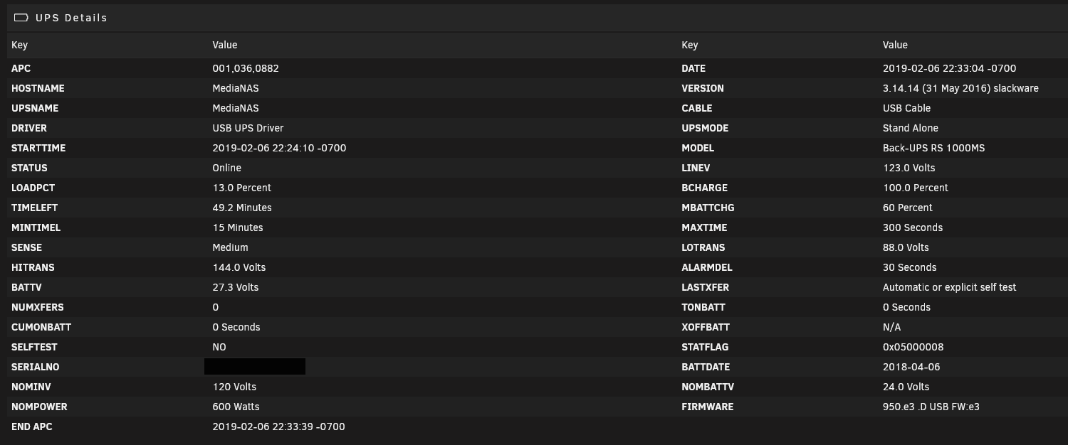

There is quite a bit of information monitored by unRAID and it sends me a notification any time the server goes on battery power (even briefly) and returns to AC power.  With the many winter snow storms we have seen recently there have been a couple of power "outages" that lasted just a couple of seconds.  It has been quite a while since the power was out long enough to trigger a shutdown.
