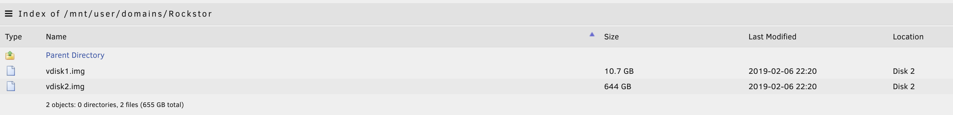

Now I have rockstor running successfully in a VM. The start partition in vdisk1.img and the data disk in vdisk2.img. The vdisk2 has a size of over 600 GB. Is that basically ok or will I have problems due to the size at some point? If that's not ok, can I solve it in unraid by creating multiple vdisks which are then combined in rockstor as stripe?
It's OK as long as it fits on the disk it currently is, since on Unraid a file can't span more than one disk, depending on the VM config it might also be limited to 2TB max.
Thanks. Good to know. It is on a 1.5 TB Disk.
