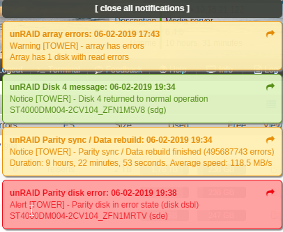

Then I removed one of the 1TB data drives and replaced it with the other 4TB I had just precleared.  Unraid noticed I was missing the 1TB drive, so I assigned the 4TB drive to that disk and started the array.  It began a prarity-sync/ data rebuild.  Everything seemed to be going fine until ~50% of the way through the rebuild when my parity drive started racking up errors like crazy.  The parity sync ended with 495M errors.  Attached are the notifications I got at the end as well as my syslog and the SMART reports.

Looking at syslog, I think you are probably right that parity disconnected after the rebuild was beyond the size of the original disk, and the Notifications screenshot seems to agree, so you are probably OK to just rebuild parity. Hang on to that original data disk just in case.

Looking at those Notifications again the rebuild wasn't complete until after the errors started. But if you are sure it was already beyond the size of the original it should be OK.

Rebuild wasn't finished when the parity errors started but it was past the data part of the rebuild, so rebuilt disk should be fine.
