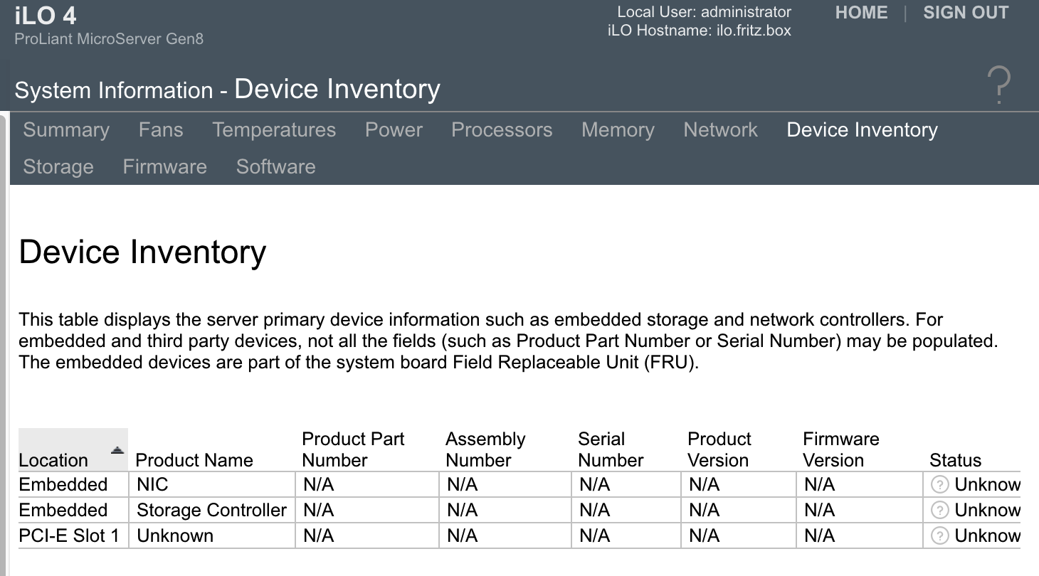

I installed a sas-9207-4i4e controller (got it for free with the server) in my HP MIcrosserver Gen8 and connected a 3TB hard disk. In ILO I can see the storage controller. In unRAID I don't see a hard disk under unassigned devices.
Do I have to install an additional driver or activate something else? Or can I check at least the drivers somehow?
Note: The HD works if it is connected directly to the SATA port of the server.
Added config zip screenshot from ILO

9207 are plug and play, please post the diagnostics, also make sure you're using the correct breakout cable, you need forward breakout, reverse breakout looks the same but won't work.
It's working! I hadn't plugged the plug all the way into the socket. the click was missing... ;-)
Sorry for running around for me and thank you very much.
