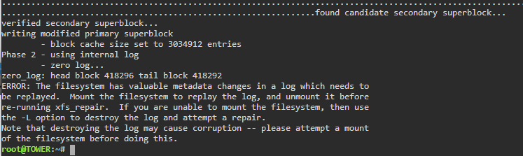

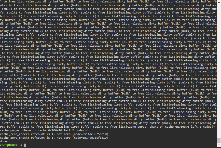

Ok, finished xfs_repair on both disk 2 and 4. The repair on 2 failed but 4 finished with the info below. Looks like I need to start the array and the stop it go back to maintenance mode and rerun the xfs_repair again?
tower-diagnostics-20190212-1100.zip
Usually you need to use -L when this happens.
Never seen that before, try running xfs_repair again, but likely won't be fixable.

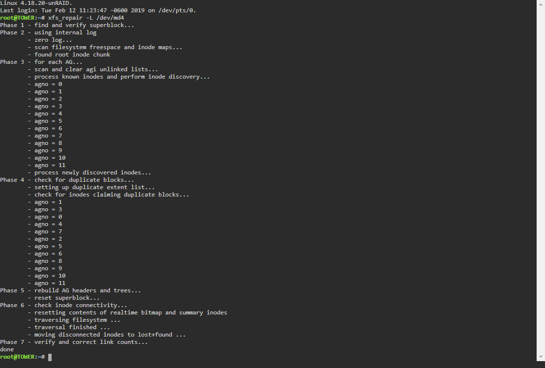

Well went ahead and ran another repair and it looks like it finished successfully this time.

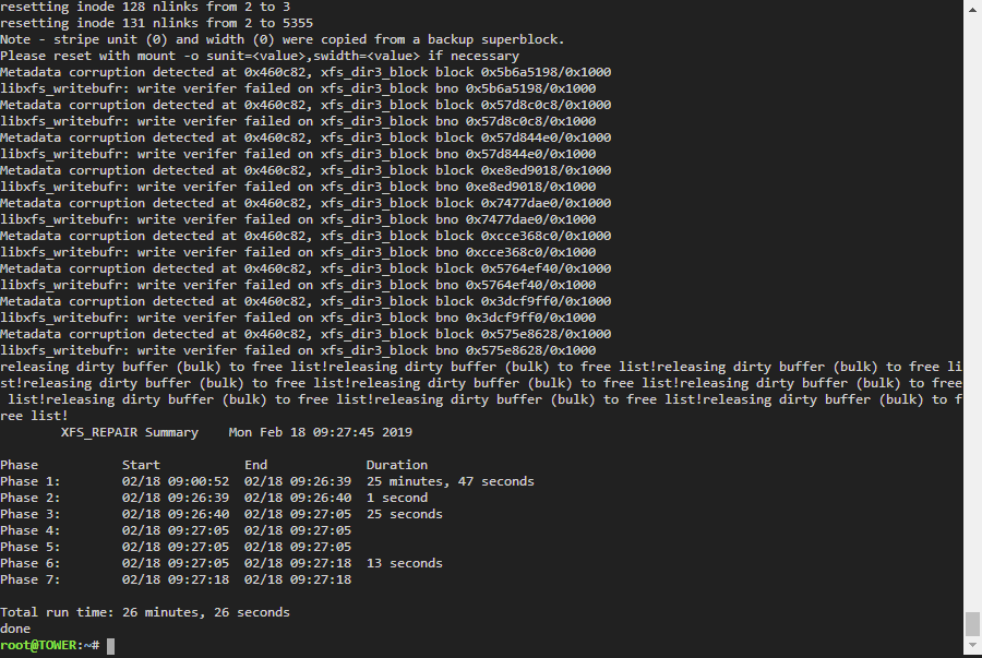

Diags are after rebooting, so not much info, try running xfs_repair again on disk4, but it appears there's a missing or damaged superblock, that's unusual.
XFS repair finished. I really don't understand what could be causing all these errors. I get that disk 4 is corrupt but how would that affect the other disks in the array. Why to do other disks randomly go red X? How do I get back to the point that it's stable? I could replace disk 4 completely but will that solve the other issues that keep recurring?
