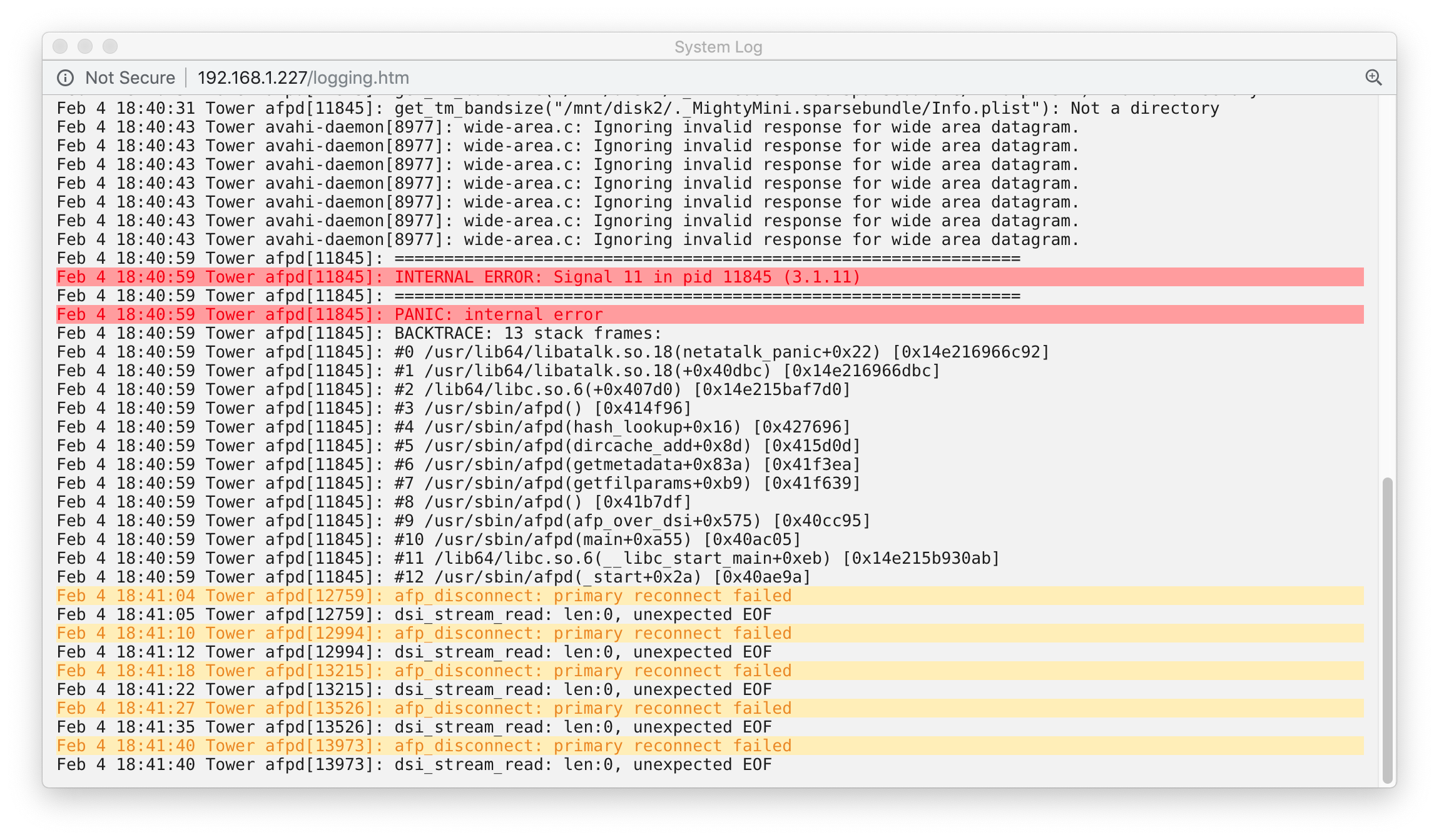

Hello, i recently upgraded to 6.6.7RC2 and AFP connection wouldnt work. I then downgraded to 6.6.6 and my AFP drives mount in macOS and i can transfer files through finder, but TimeMachine no longer works. I even tried going back to 6.6.5 and my TimeMachines still doesn't work.
I tried restarting server, restarting client mac, and even stopping AFP and SMB in unraid settings, and re-starting them. Still the error persist. What else can i try? I checked to make sure the shares are ok, and that they have AFP enabled.
The TimeMachine connects to a disk share, that is setup as AFP with secure and my user account is listed as read/write.
Here is the errors im getting.

You can try rebuilding the Netatalk database, as follows. Unmount all AFP-mounted shares (or just shut down your Mac). Then from the Unraid server's command line, or using MC or Krusader or Dolphin dockers, delete the .AppleDB folder in the root of each user share. Then start your Mac or re-mount the shares. They will take a while longer to mount than usual because the database has to be rebuilt. You can improve speed and reliability by moving the databases off of the array and onto your cache pool. I've posted information about how to do this before. I'll try to find a link to it.

Thanks John_M i was able to re-upgrade to 6.7RC2 and found a setting to turn on timemachine in the SMB settings, then i was able to setup the disk share as TimeMachine under SMB. My mac can now perform TimeMachine Backups. I do have the dB path for all my shares on the cache, drive in a cache only share. The one i forgot to do one for is my disk2 share. ill try that tonight see if it helps. I might stick to SMB if it continues to work tho.
If SMB works reliably with Time Machine then by all means use it instead of AFP. I have a few old Macs from the Snow Leopard and Lion era that can't run the newer macOSes so I need to use AFP.
