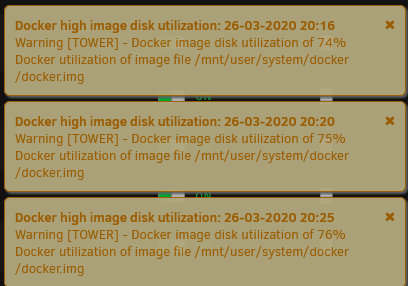

I am getting these warnings:

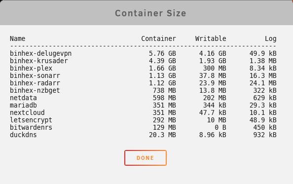

I did a docker container size and got this:
Did I mess up the setup?
I did as was suggested that I use the cache drive and mover.
The disk utilization looks to come from writeable/container = 72%

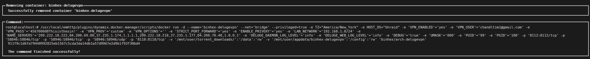

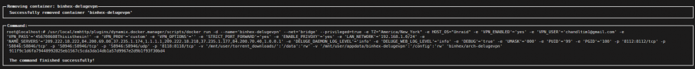

Post your docker run command for this new docker as explained at this first link in the Docker FAQ:
trurl,
I hope I understood what you were asking.
I changed the deluge docker to debug and the following was the output from the run command:
Let me know if this is what you were looking for and/or do you need something else???

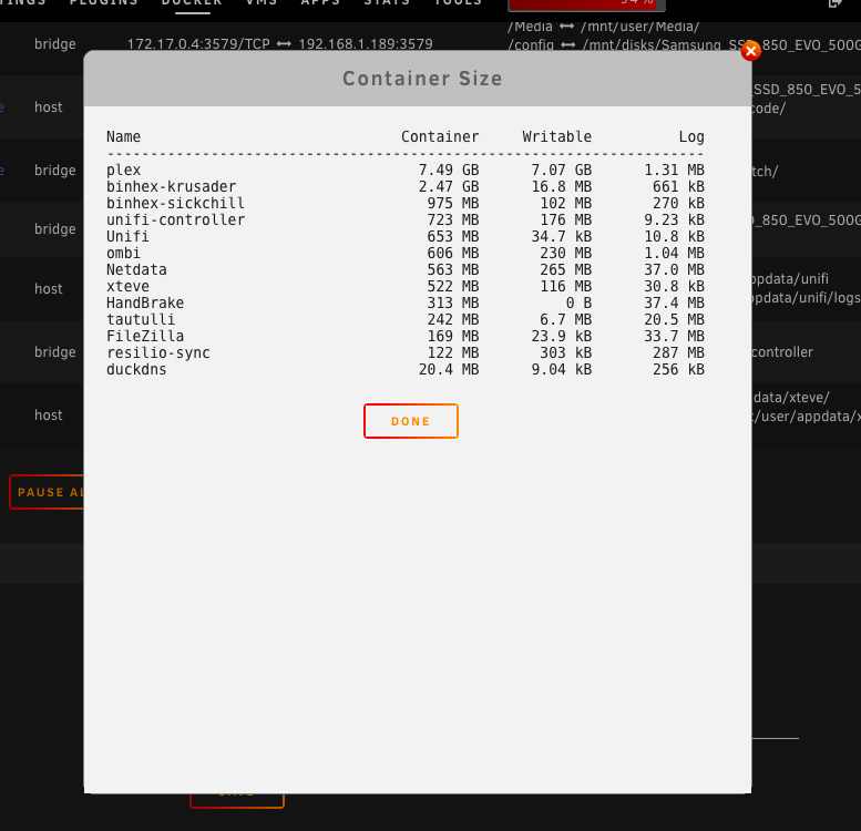

@tmoran000  Post a screenshot of the popup that happens when you click Container Size on the Docker Tab
here is the info
Edited by tmoran000
You will have to delete that docker image as @Squid suggested to get it fixed, even though log size doesn't seem to be the issue. But you need to figure out what you have done wrong to make this happen.
Any idea why your plex container is so large? You are almost certainly writing to a path that isn't mapped. With plex, about the only writing it is going to do is transcoding, and recording. For comparison, my plex container size is only 723MB.
Krusader, the second on the list, is known to be somewhat large so that is probably fine.
