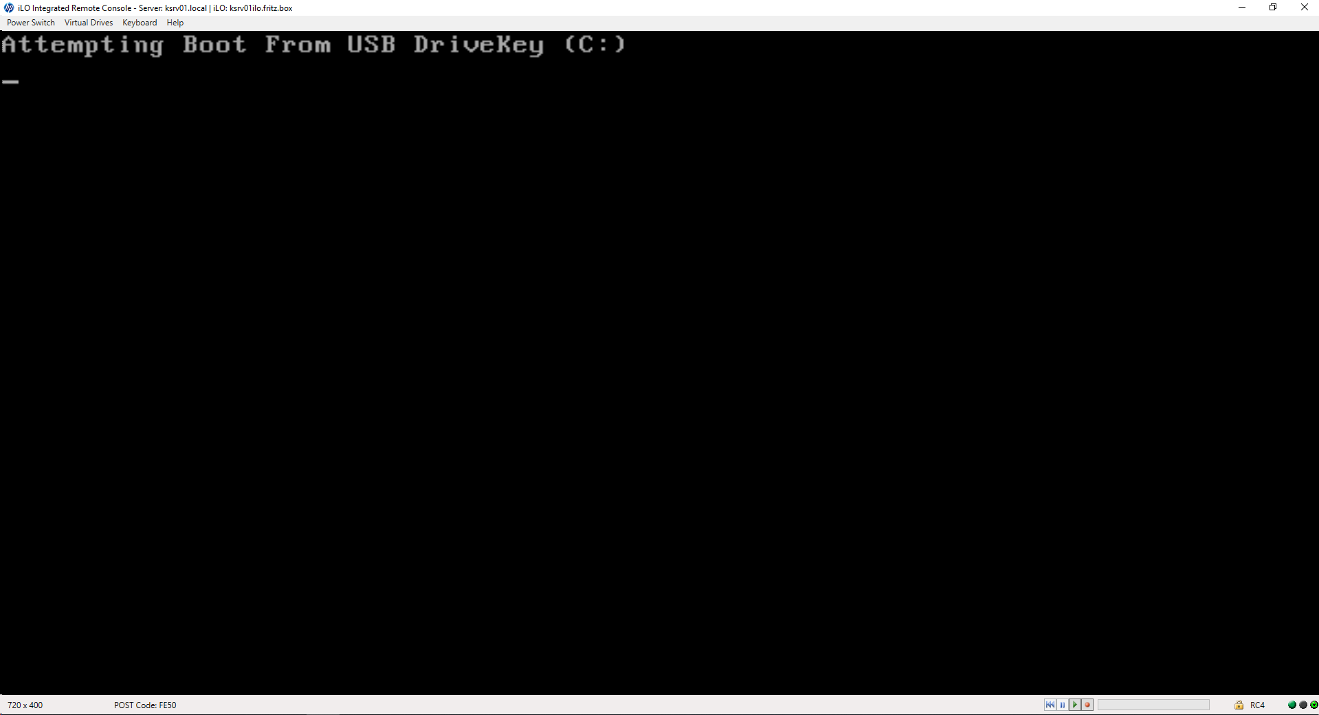

I recently wanted to switch from ESXi to UnRaid. After I installed the system on a USB drive I tried to connect the usb drive to the internal USB 2.0 port in the Microserver. But after setting all bios options the usb drive didn't start. It just told me "Attemping to Boot from USB DriveKey (C:)" but at this point it stopped doing anything. So after this I tried 3 other usb drives and all off the available usb ports on the server without a success.
