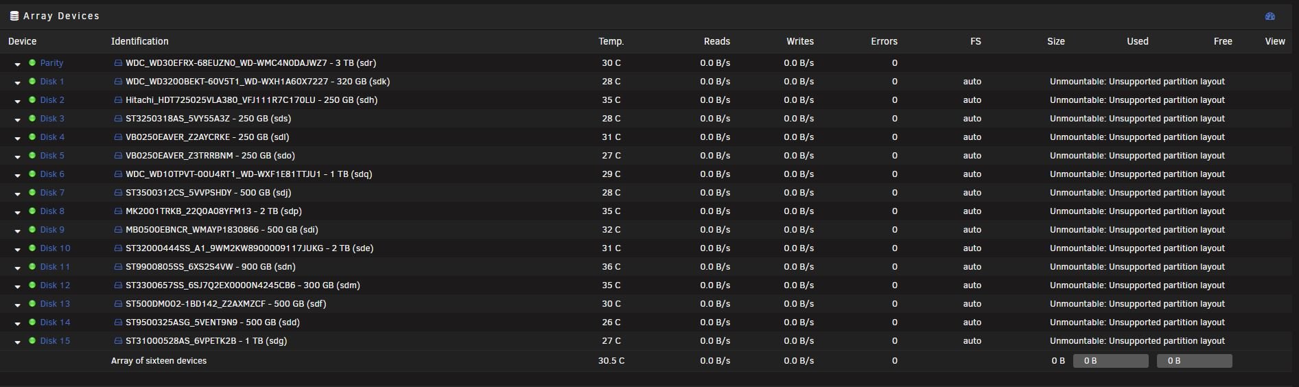

So, i had up until about half an hour ago, an Adaptec 6805Q RAID card installed in my system which  is a 16 bay Supermicro server.

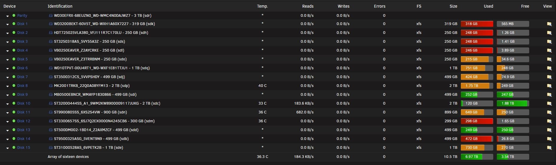

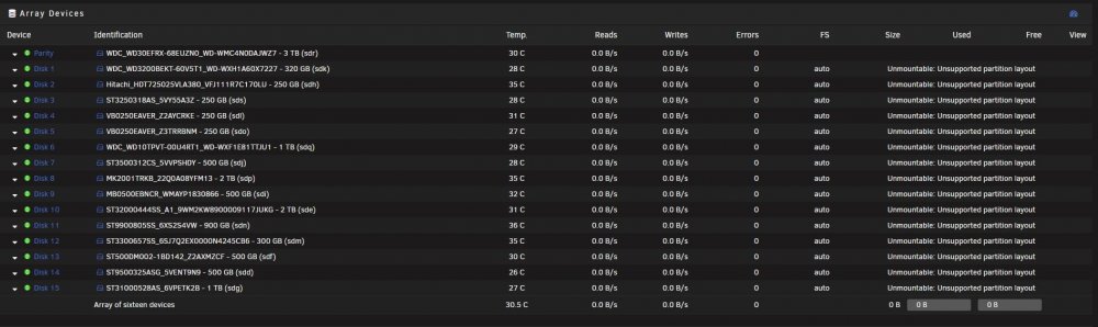

I decided about two weeks ago to switch over to a HBA (or at least a card that acts as if it is a HBA. I therefore bought a LSI card (i can find out the model if you need it) to replace it with. I have just done a swap however ALL my drives have shown up as unmountable. I had followed this thread.
Attached are screengrabs of the drives before, the drives after and the unmountable disk list.
Advice or support would be greatly appreciated. I would really like to get this back online ASAP.
The array is currently sat started and i will leave it well alone until i get some advice.

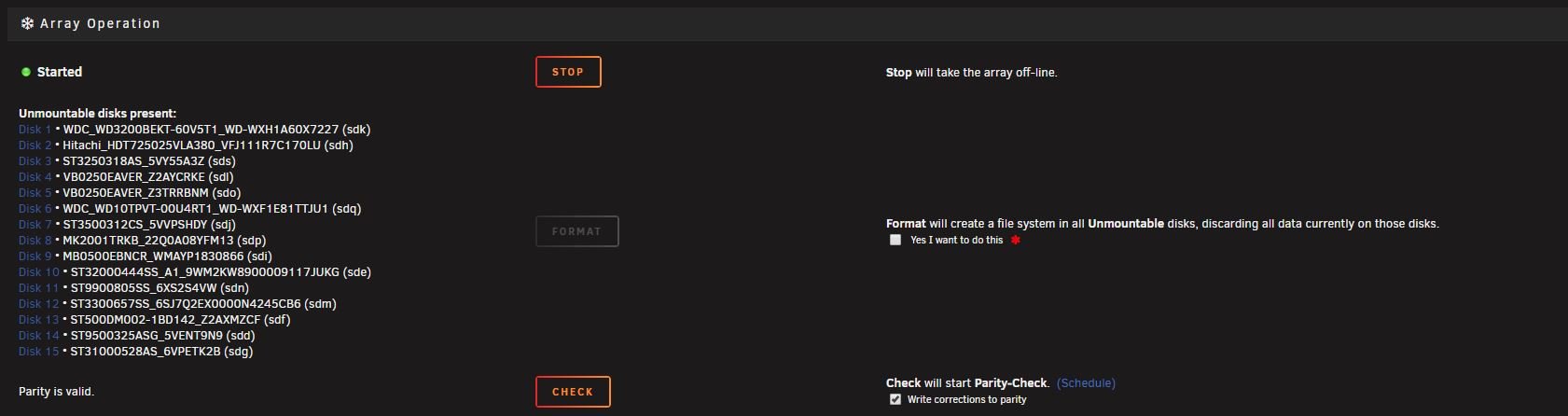

Attached are my diagnostics in full so someone can browse if required.
I have since stopped my array and will leave it in this stopped state. I am starting to wonder if the new config tool thing did not work?
Any help to resolve this will be much appreciated.

That's one of the many reasons RAID controllers are not recommended.
Since partitions are outside parity and recreated by Unraid on rebuild the only way to keep the current controller would be to rebuild each disk, one by one, others users have done the same recently, you can test with just one disk, stop the array, unassign one of the data disks, start the array, emulated disk should mount, check that contents appear correct and run a filesystem check, if all is well you can rebuild on top of the old disk, though rebuilding on a new one would be safer, then you'd need to repeat the process for the remaining disks.
Alternatively continue using the old controller.
