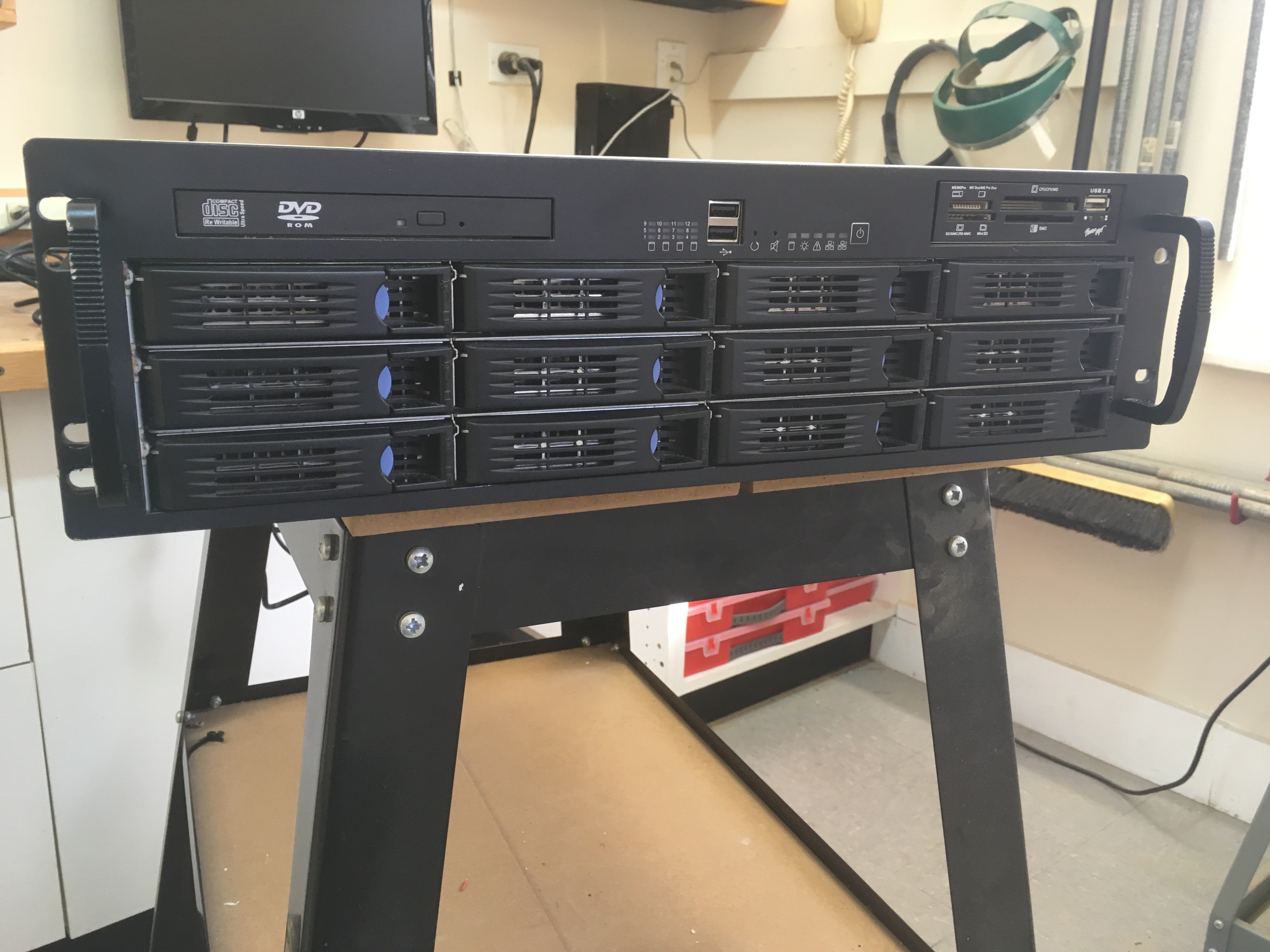

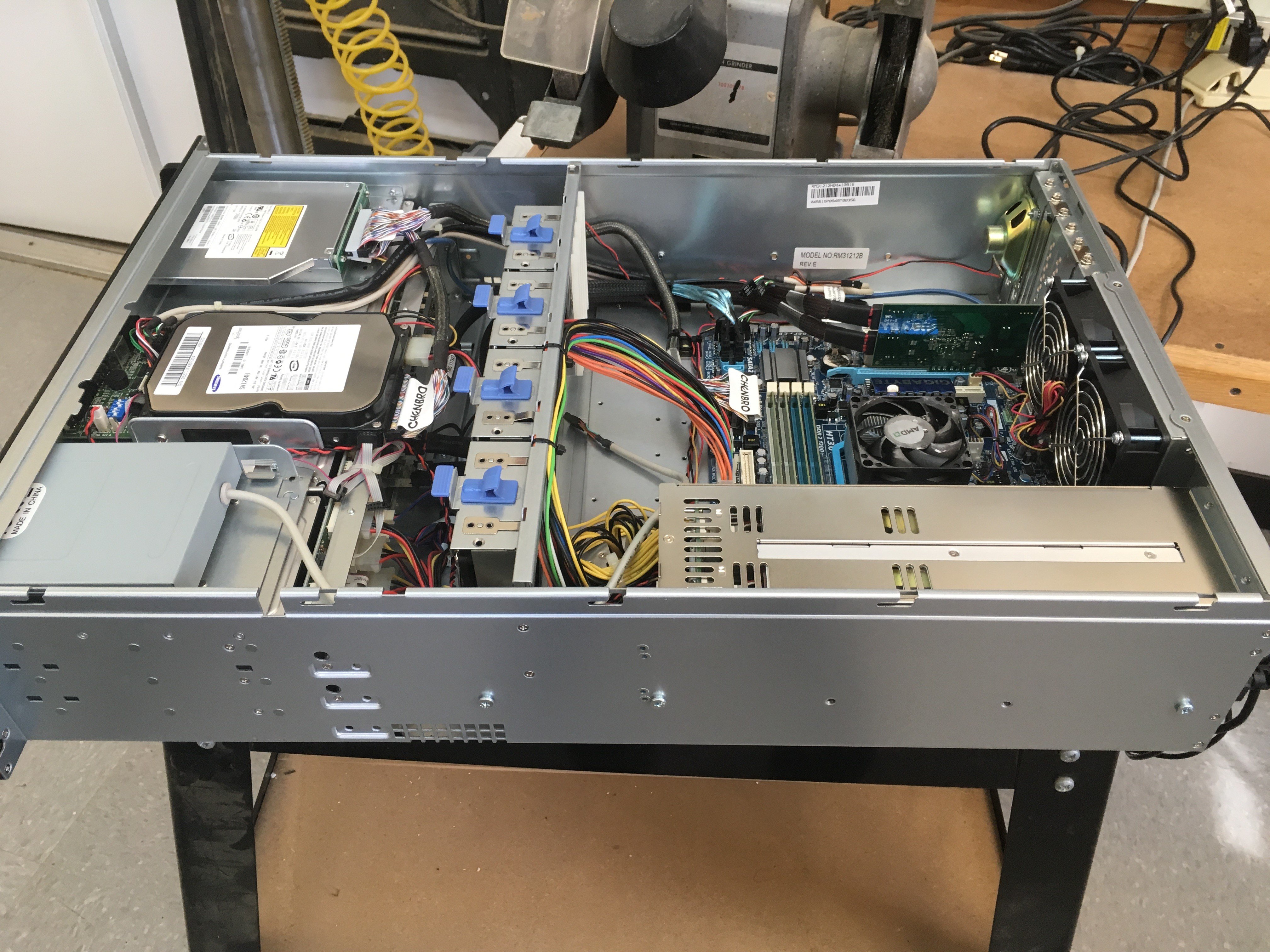

For those interested here are two pics of my 10-year-old server sitting out of the rack. In the open case picture, you can see the two PSU's in the lower right and the internal hot-swap fans at about the midline.  The front (left) shows an optical drive (DVD), An internal HDD which is not used but has WIN XP on it and can be booted, and a general media interface which is not plugged into the mobo. At the rear of the case are two exhaust fans.  The case and its components are very loud, hence it being in the server room and not the theater.
