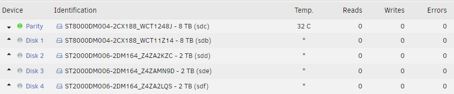

Nope same thing, disks all spun down but parity drive up with 0's on the stats:
oooooh - doh didnt realise you can set drives individually; was set to never!
thanks for the advice.
