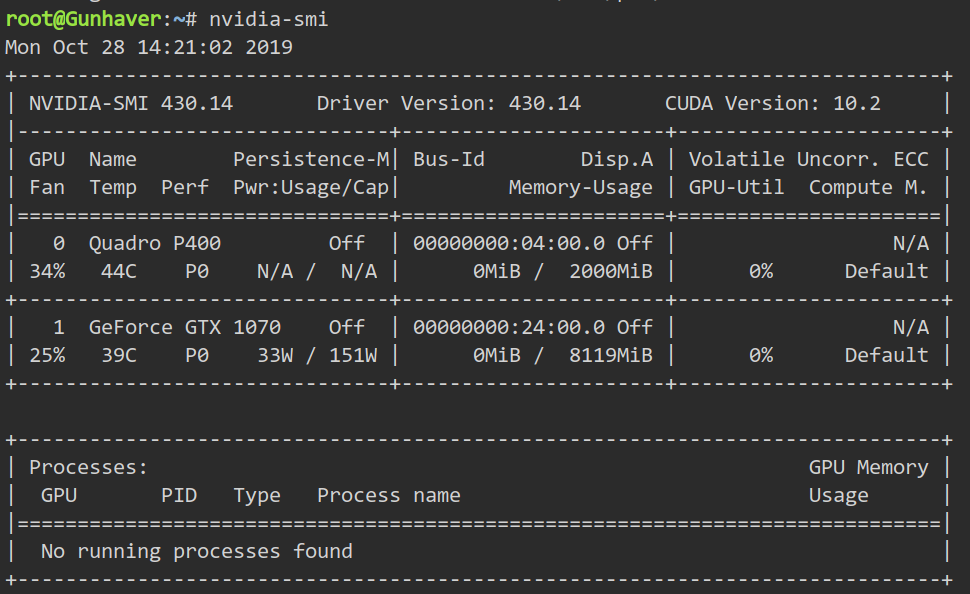

My Quadro stopped showing up in the plugin settings page a few weeks back, and yesterday Plex and Jellyfin both wouldn't launch after updates. I tried re-installing the plugin but it has the same issue...
nvidia-smi sees the card there (The 1070 is isolated for a VM, and I don't think the settings page ever saw it before).
Is my card dead or something??
gunhaver-diagnostics-20191028-2021.zip

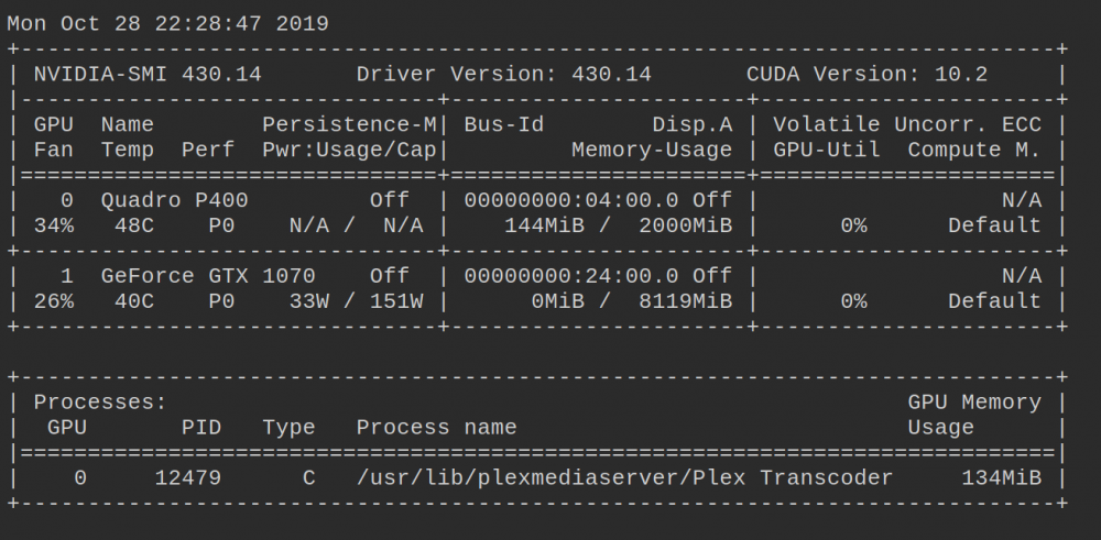

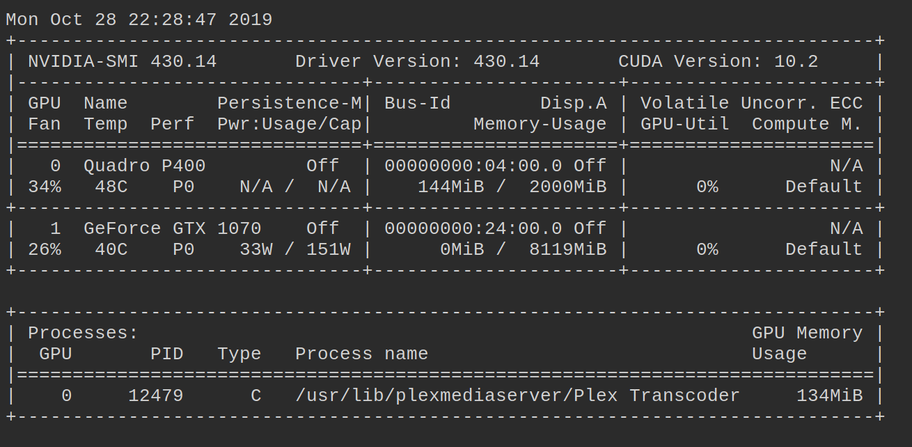

It could be that your Plex and jellyfin dockers are seeing the 1070, then failing because your vm is using them.  Try disabling the vm and seeing if it launches.  If it does, and then uses the 1070, then you know the problem.
After a reboot Plex will transcode, but nvidia-smi still shows the card as powered down(??) and the nvidia settings page still doesn't show it.

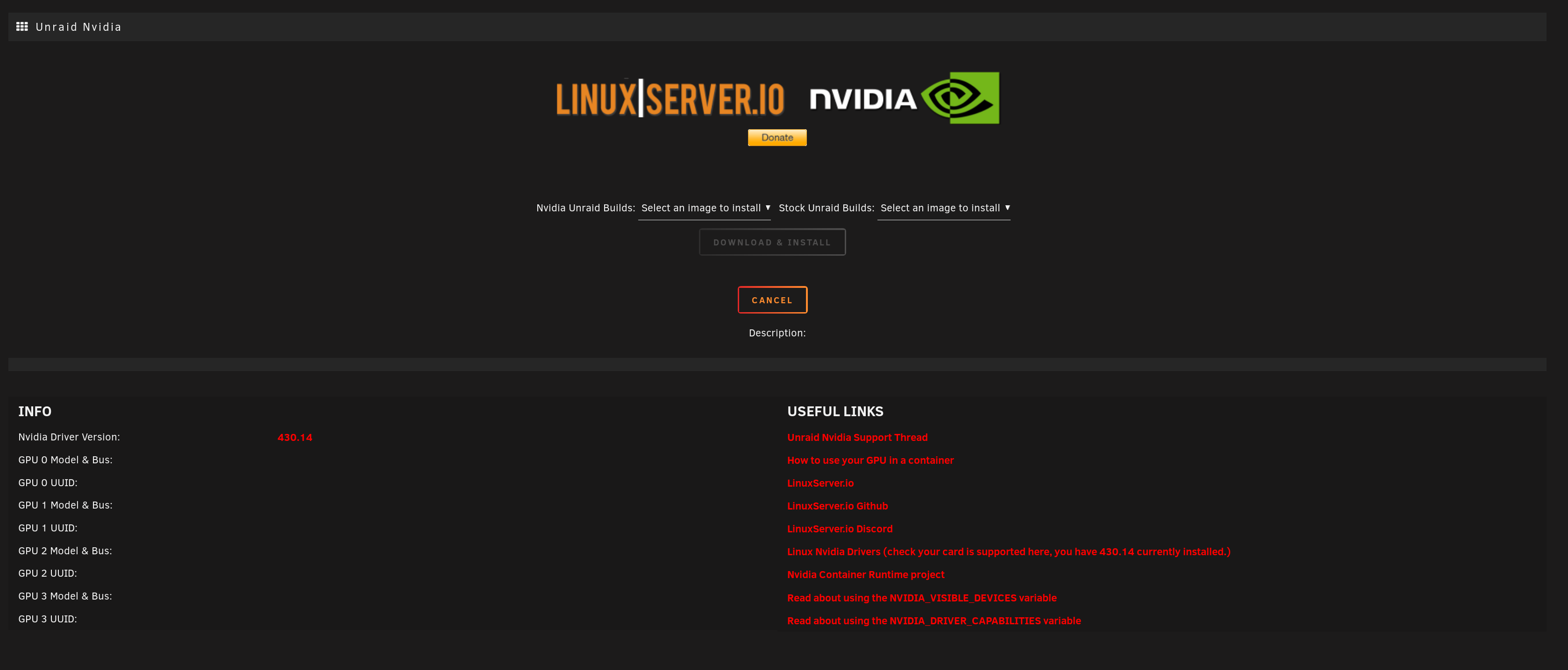

Any reason why my 980 is not seen anymore?
Version: 6.8.0-rc5
Nvidia Driver Version:430.50
GPU 0 Model & Bus:No devices were found
IOMMU group 32:[10de:13c0] 43:00.0 VGA compatible controller: NVIDIA Corporation GM204 [GeForce GTX 980] (rev a1)
[10de:0fbb] 43:00.1 Audio device: NVIDIA Corporation GM204 High Definition Audio Controller (rev a1)
skynet-ur-diagnostics-20191105-0928.zip

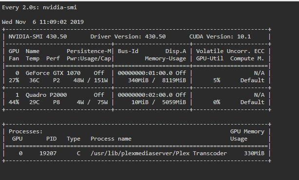

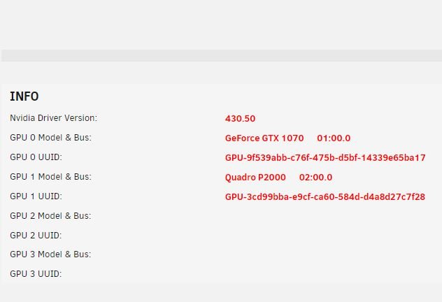

First, thank you for making this. It has been a huge help offloading my CPU with GPU in Plex.
However, I am having an issue. I have a Geforce GTX 1070 and a Quadro P2000. I use the Quadro for pass through to the Plex docker and I want to use the 1070 for pass through to my VMs. Here is the issue, When the 1070 is installed in my machine, Plex uses it instead of the Quadro. "watch nvidia-smi" confirms that transcoding is happening on the 1070. I have tried switching PCI ports and have verified that the GPU UUID in the Plex container is the one for the Quadro.
Any help would be greatly appreciated.

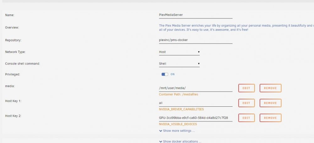

I think you can change the "all" to the # of the card in the NVIDIA_DRIVER_CAPABILITIES variable of your PLEX docker.  That will isolate what NVIDIA card is passthru to this card instead of passing it all.

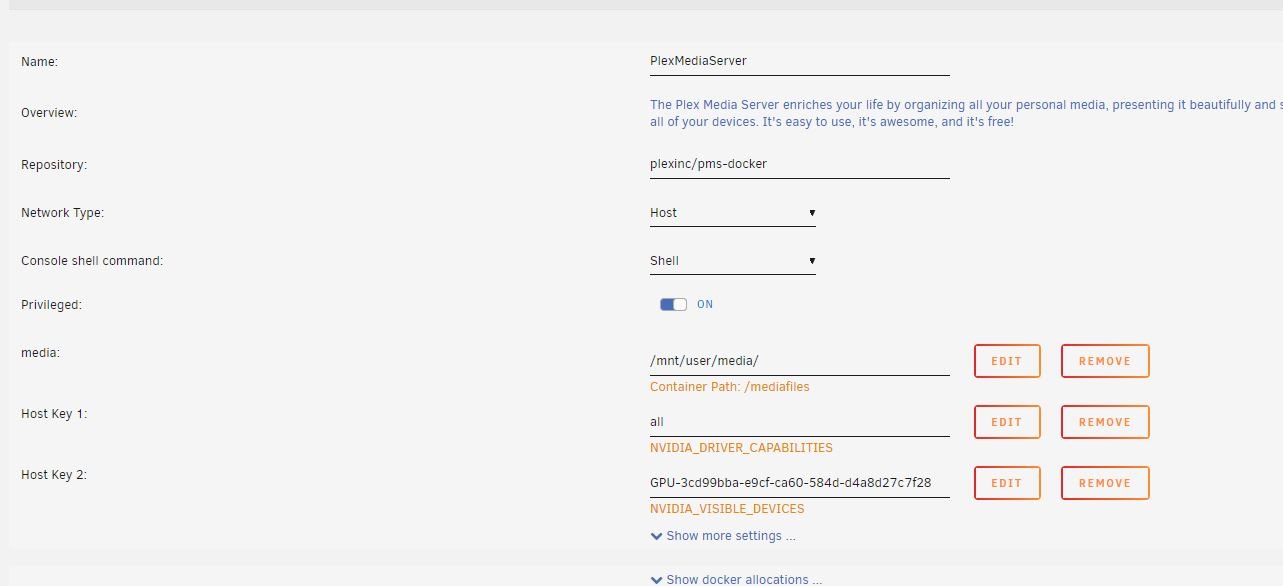

Thank you for the reply. I tried to change the value to 1 from all, and got a startup error from plex. Here are my settings.
I have a similar setup. I never encountered this issue, but I’ve always had the gaming GPU stubbed and passed to the VM. If you stub the card, the NVIDIA plugin won’t see it at all, thus eliminating any possibility of it using the wrong card. I suggest trying that if you don’t need the 1070 outside VM usage.
Thank you! No, I won't need that outside of VM. How do you stub the card? Also will it stay locked even if the VM is off?
EDIT: I looked up how to stub pci devices. I added pci-stub.ids=10de:10f0 to the flash drive append area. I will give this a go and see what happens. Thanks again.
Edited by veritas2884
I have exactly the same issue as above running a gtx 1060 and a quaddro p400. doesnt matter what UUID i put into the container it always picks the gtx 1060. thought i was doing something wrong but ive been trying for days to get it to transcode on the p400
So the stubbing that was mentioned didn't seem to work, but I am not sure that I did it properly. However, I will say that if you stop the Plex container, start a VM that uses the 1060, then start the Plex container again it will only use the Quadro. Downfall here is that you need to leave the VM running to all the time or it will fall back to the 1060.
