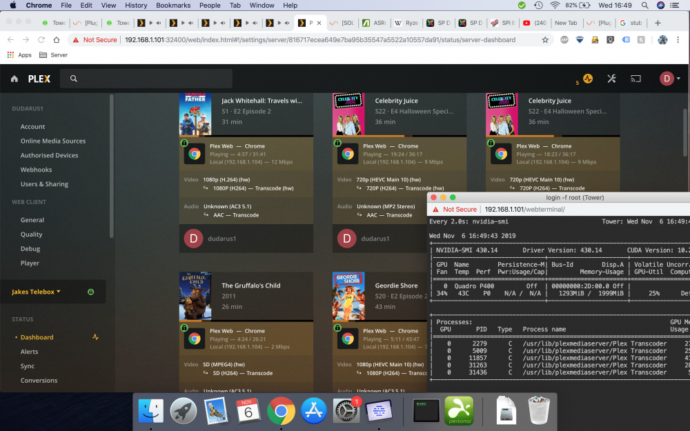

so i started the vm with the gtx 1060 passed through and tried some transcoding and it worked but for some reason plex has forgotten about the 2 transcode limit which it definetly had without the vm running
