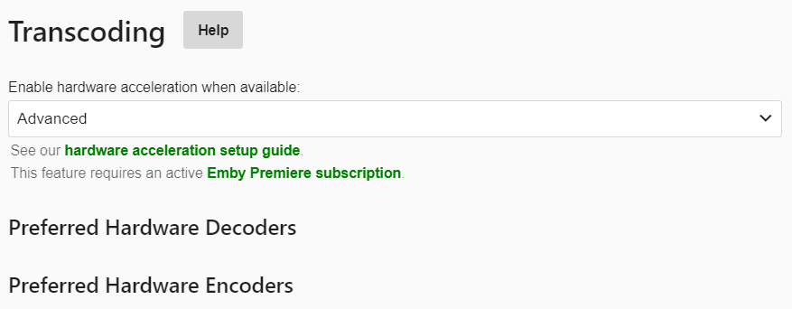

What is enable hardware transcoding set to? It should be set to advanced if you want to see it enabled for different codecs on the transcodes page. If you only have it set to yes, no list will appear, but it will still work.
Have you tried to play a file and see if it's hardware transcoding?

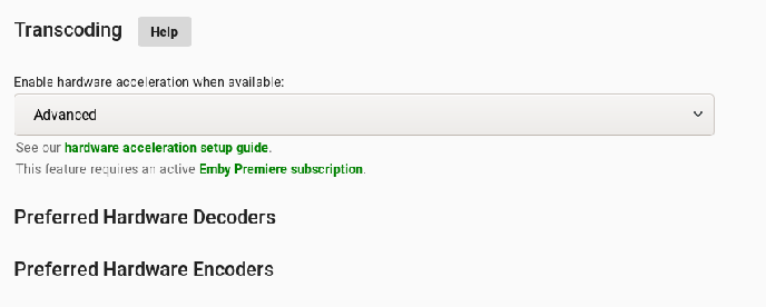

Yes, I set it to Advanced and just see the "Preferred Hardware Decoders" and "Preferred Hardware Encoders" headers, but nothing is shown under them:
Are there any commands that I can run to see if it's being passed to the Docker container?
I also verified that when I transcode that it's software transcoding.

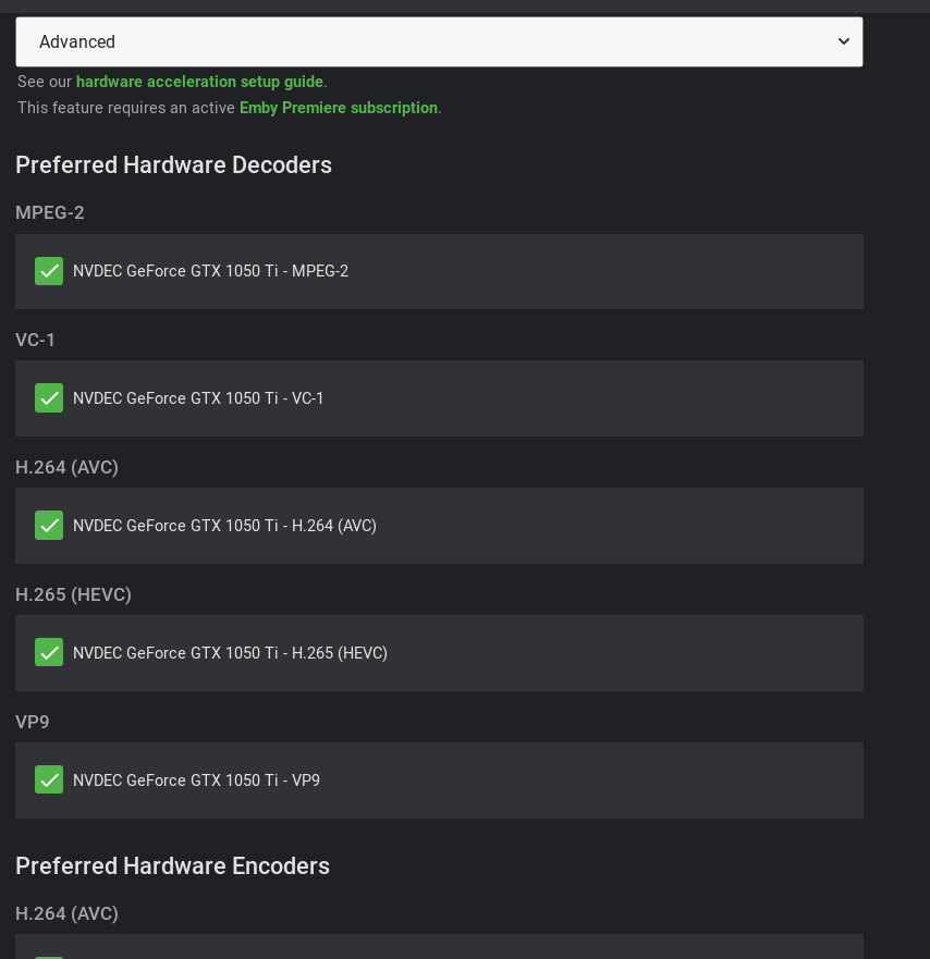

So my Emby trancoding settings look like this.  Do you have Emby Premiere?
No, all those items are missing, only the headers appear.  I do have premier and it's activated.

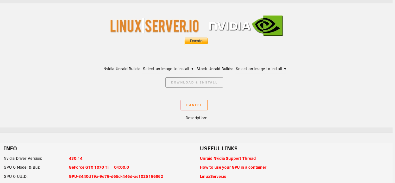

Post a screenshot of your Unraid Nvidia Page and a copy of your docker run command.
Sent from my Mi A1 using Tapatalk
Sure!
