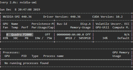

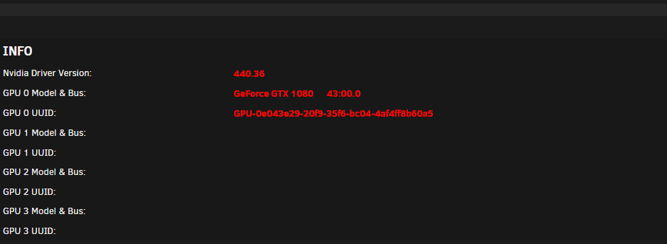

Let me start off by saying, thank you for the work that goes into this plugin. Honestly should be something that is built into Unraid by default. Anyway, I am now upgraded to 6.8 RC9 but I do not see my quadro card as an availble card.
But using watch nvidia-smi I see my quadro (1080 is being used in a VM)
Any reason why I no longer see the P2000?
Thank you
Probably since it's passed through to your vm?
he is using the gtx1080 to the VM, not the P2000 ;)
Thank you
Is the Quadro still supported on the driver version?
Sent from my Mi A1 using Tapatalk
