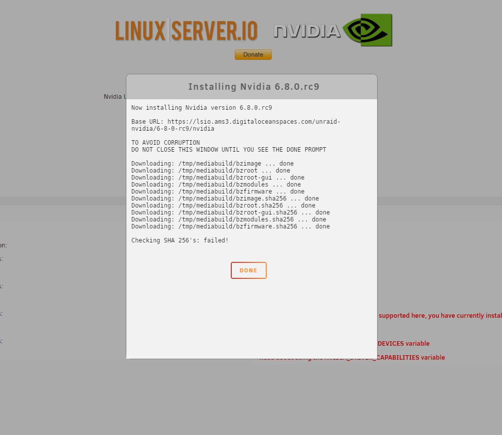

Hi All,
I have a bit of a problem here..
New unRaid user, so forgive my ignorance (I've tried searching to no avail)
When I try to install the unraid nvidia plugin it installs fine, i then reboot, then try do the "choose the nvidia unraid build" (I select the one that matches my unraid version) and it goes through and downloads fine, but the SHA256 checksum fails... every time.
I've tried it with 2 versions, 6.8.0-rc7 and 6.8.0-rc9 ...
Is there a particular reason it's doing this? I can't find anything in the logs....
Help appreciated, and thank you in advance

4 hours ago, iamyogo said:
Hi All,
Turn off any piHole if you have anything like that. That was my culprit.
Nope, still a fail... Will run a memtest to see if that's the cause...
I have tried to download and set up for the first time and am also getting SHA256 failures. Trying to download and install 6.7.2. I don't have pi-hole are anything in-between.
Bitter sweet to know I'm not the only one.... I'm currently running a memtest, but it's looking OK so far, all passes
EDIT: All tests passed on memtest
Edited by iamyogo
I have no idea what happened... I didn't change anything, but it just passed the SHA checksum verification....
It's now working
