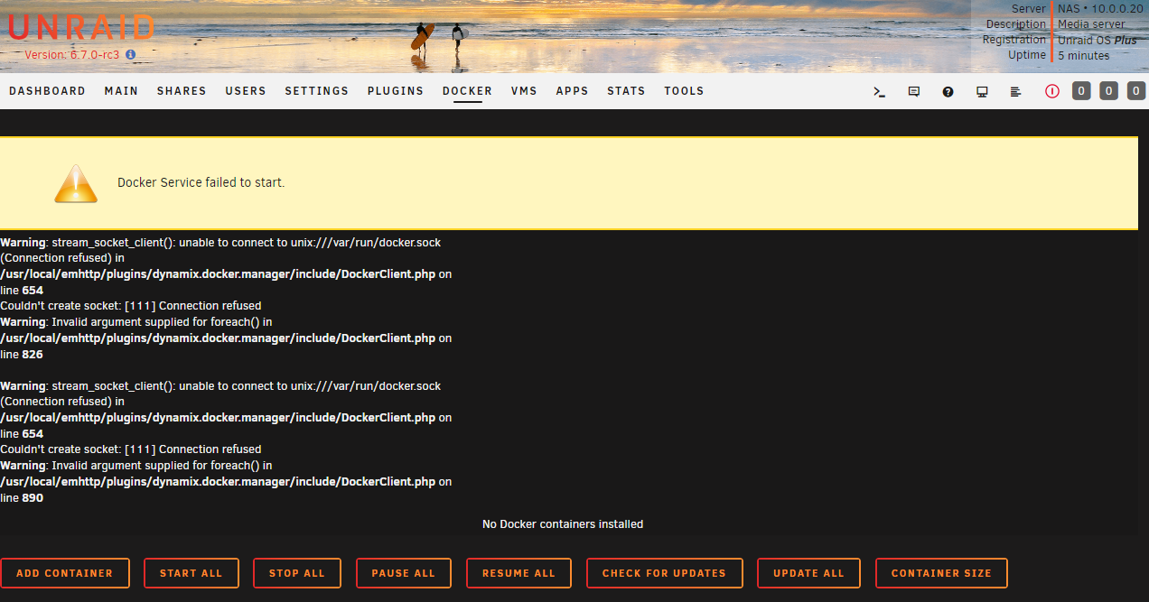

Docker service wont start
I get the following error message
Warning: stream_socket_client(): unable to connect to unix:///var/run/docker.sock (Connection refused) in /usr/local/emhttp/plugins/dynamix.docker.manager/include/DockerClient.php on line 654
Couldn't create socket: [111] Connection refused
Warning: Invalid argument supplied for foreach() in /usr/local/emhttp/plugins/dynamix.docker.manager/include/DockerClient.php on line 826
Warning: Invalid argument supplied for foreach() in /usr/local/emhttp/plugins/dynamix.docker.manager/include/DockerClient.php on line 890
Does anyone know what that means and what I should do about it?

Image where I got the error-message

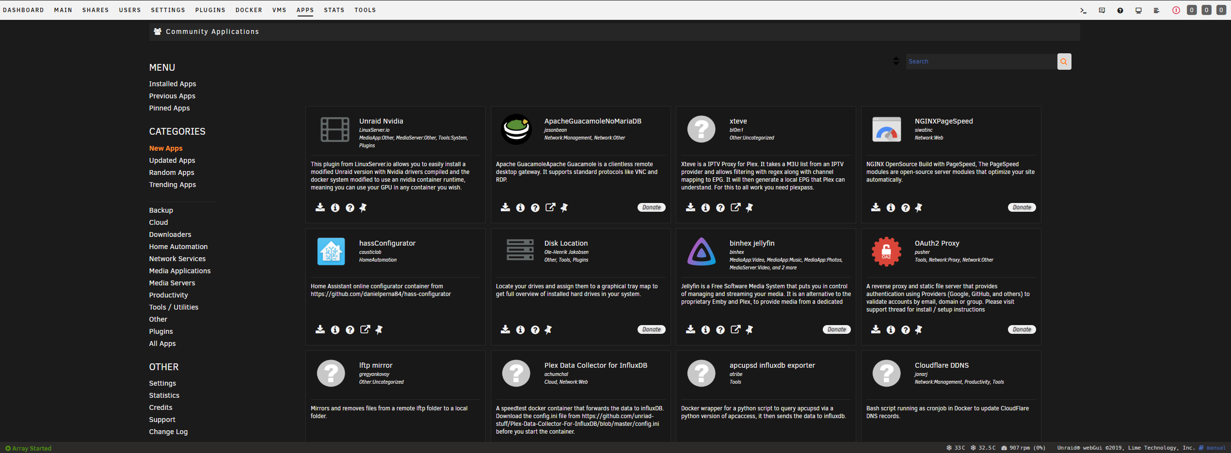

Previous Apps
3 minutes ago, CHBMB said:
The apps tab. And there will be something there to reinstall existing applications or something along those lines.
Sent from my Mi A1 using Tapatalk
Am I looking in the wrong place? :/
1 minute ago, Squid said:
Previous Apps
Ok, that's what I thought :) I had just hoped there was a "restore" button xD
