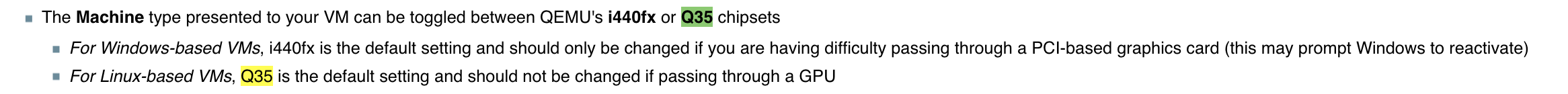

Hi @Warrentheo, thank you for your input.  I always thought though my games aren't in much hurry (except for Fortnite), it won't be CPU intensive.  Come to think of it, you are right.  Since simulation is being done, it will use up a lot of CPU power.  And I also agree 8 GB is required.  I'll try to assign 3 cores/ 3 threads to it, so at least I get around 3.5 cores :D . Is it safe to change VM to Q35?  Do I just select Q35, and save, and start?  I saw this from Unraid wiki-
1703148952_ScreenShot2019-02-12at11_53_26.thumb.png.bd53f4836c09b1162aa2850e48080362.png
Is it still suggested?  If you're sayign Q35 is the newer system (chipset), then I'm all for it as well.
Switching from one to the other is like yanking the hard drive and putting it in a different motherboard... The i440fx is an ancient chipset for the Pentium 1+2 that never heard of a PCIe slot...  Backups should definitely be done, and when you switch it and try to boot, it will take forever to reinstall every single driver on the system...  While in my experience it usually works without issue, I won't be responsible if you skip the backups...  I also would not expect a major improvement over the i440fx since even though it is having to run additional overhead, it is not that major...  I mainly mention it because you and so restricted on the hardware you gave the VM...  I have noticed other compatibility issues that still makes it worth it, and the only downside was in the past the q35 hadn't had as much testing...  IMO there is no longer any reason for i440fx in windows anymore...

@jordanmw, then my question is, what is causing lag in mouse.  It's the main thing that annoys me.  I'm streaming 1080p.  I'm using wired 1 Gbe, my Intel nuc has Intel Nic, my switch is HP Gigabit switch, and my Supermicro board has dual Intel Nic, with only 1 nic being used.
@Warrentheo, I gave it a try, and got this:
VM creation error
XML error: The PCI controller with index='0' must be model='pcie-root' for this machine type, but model='pci-root' was found instead
Most likely you tried to just flip it in the VM settings, but the change is too much for the WebGUI or manually editing the VM's XML...  What you do is just create a new VM, but point it at all the existing image files, that will get all the sub devices sorted out correctly...  Be careful doing this though, when the new one is working and you delete the old one, it will try and delete the "old" images files at the same time...  One more reason to make sure your backups are up to date...  When you are all done, you can move the image files around manually to make it look like normal...
