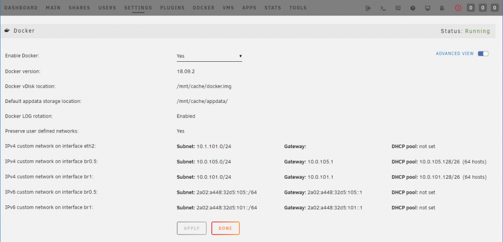

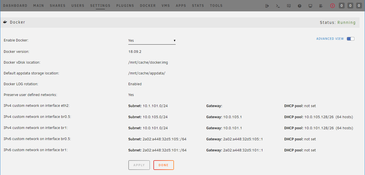

February 17, 20197 yr This file defines the physical interfaces present in the system. Use Settings -> Network Settings to configure these interfaces. Docker interfaces are configured under Settings -> Docker. You need to stop the Docker service to make changes. These are my Docker network assignments (I use both IPv4 and IPv6). Any physical interface which has an IP address defined under Network Settings (such as eth0 or br0), will have automatic docker network assignments. You can define physical interfaces without IP address (IPv4 address assignment = None), this allows to add manual docker network assignments to an interface.
