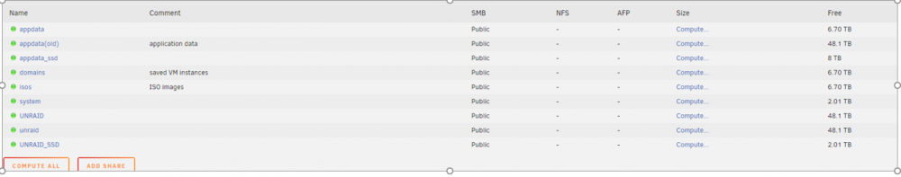

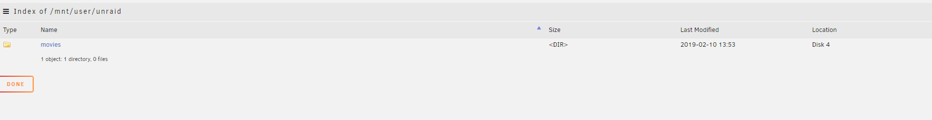

Messed up and created a duplicate share
I am new to unraid, and I recognize Linux OS is case sensitive. At some point I must have typed my user share in a docker app that is "UNRAID" as "unraid", I now notice i have a unraid and UNRAID and a subdirectory within them "MOVIES" and "movies". How do i get rid of one of them (preferably the one that doesnt have terabytes of data in it)? If I go in with Krusader and delete the contents of one of them will it delete the contents of both?. The one that is the error only has one subdirectory "movies" where the correct one has mutiple subdirectories for various media types.

So after I put the post up I mustered up the courage and tried Krusader, it was successful. Thanks!
Have you fixed the docker or whatever that created the share? If not it will just get created again.
You should be OK to work with this in Krusader since it will treat them as different.
Good thought, yes I did fix the docker as well. Thanks!
