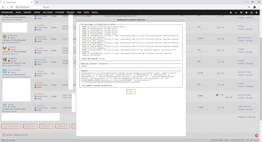

Here's an example of what I'm talking about:

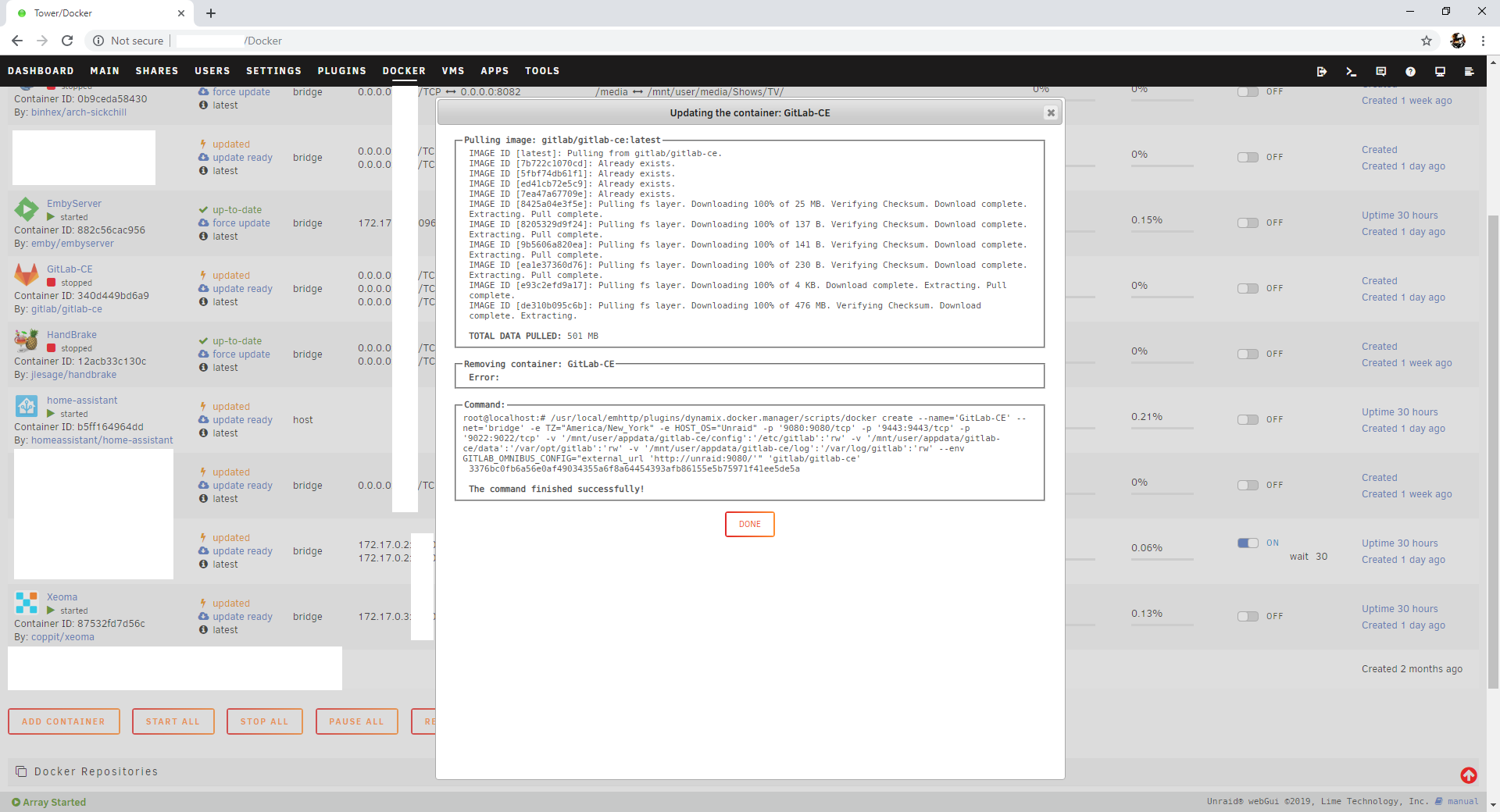

In this example, I see that Gitlab-CE has "update ready" so I go ahead and click it, this is what I see:

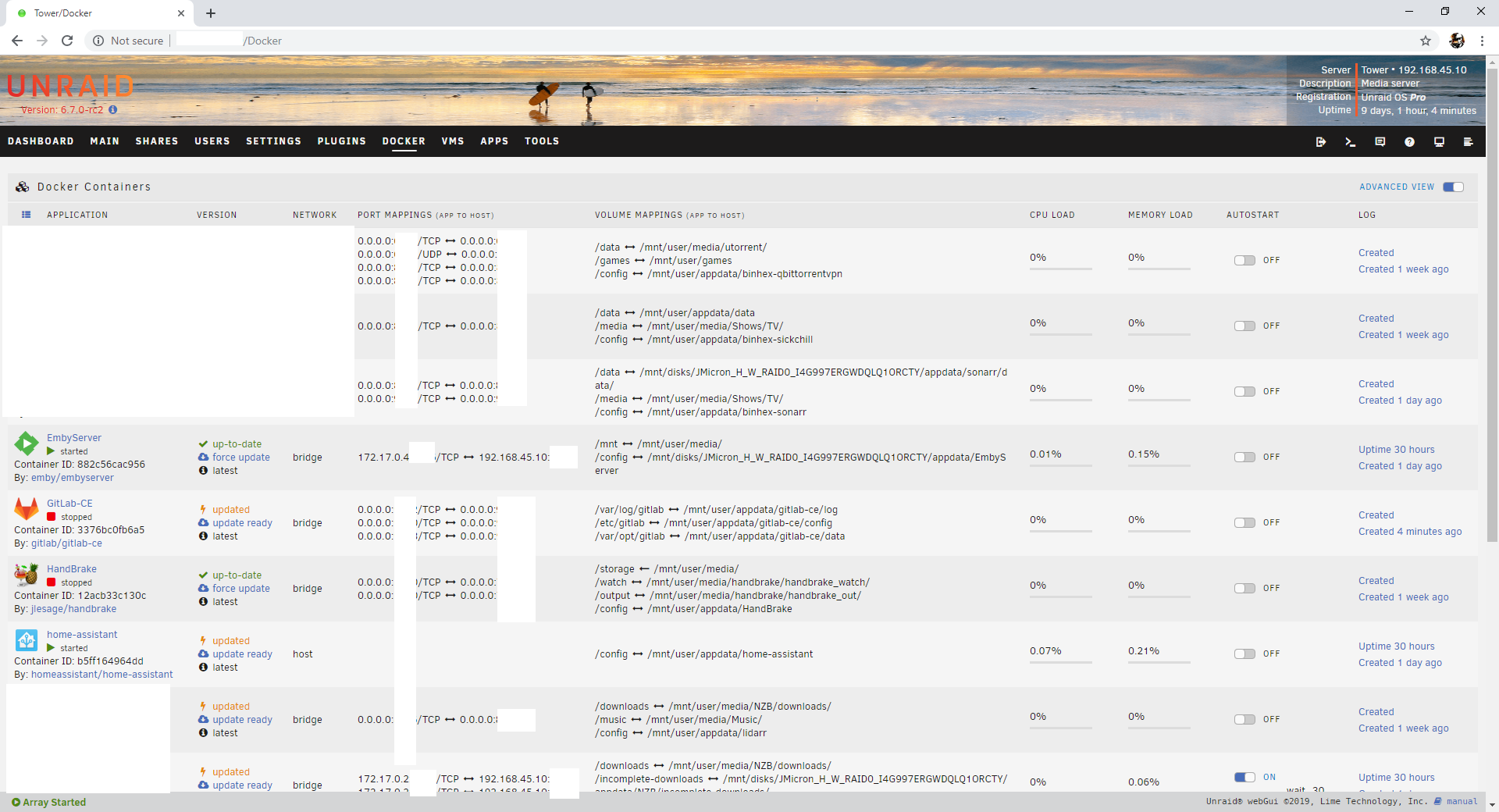

I go ahead and click done. This is what I see next, even after I reload:
I guess it updated? Or it didn't? Couldn't really say... I'm supposing not since it's still saying "update ready".
I did update, see creation time (4 minutes ago). Not sure why the status stays at "update ready".
I don't think it did update, it did _something_ but then just re-spawned at the same version as it was before. This issue is happening across a couple different containers sporadically too - today home-assistant/home-assistant is having this issue when it hasn't previously... I've noticed that the issue might sort itself out later on sometime... I just wish I'd know why this might happen.
