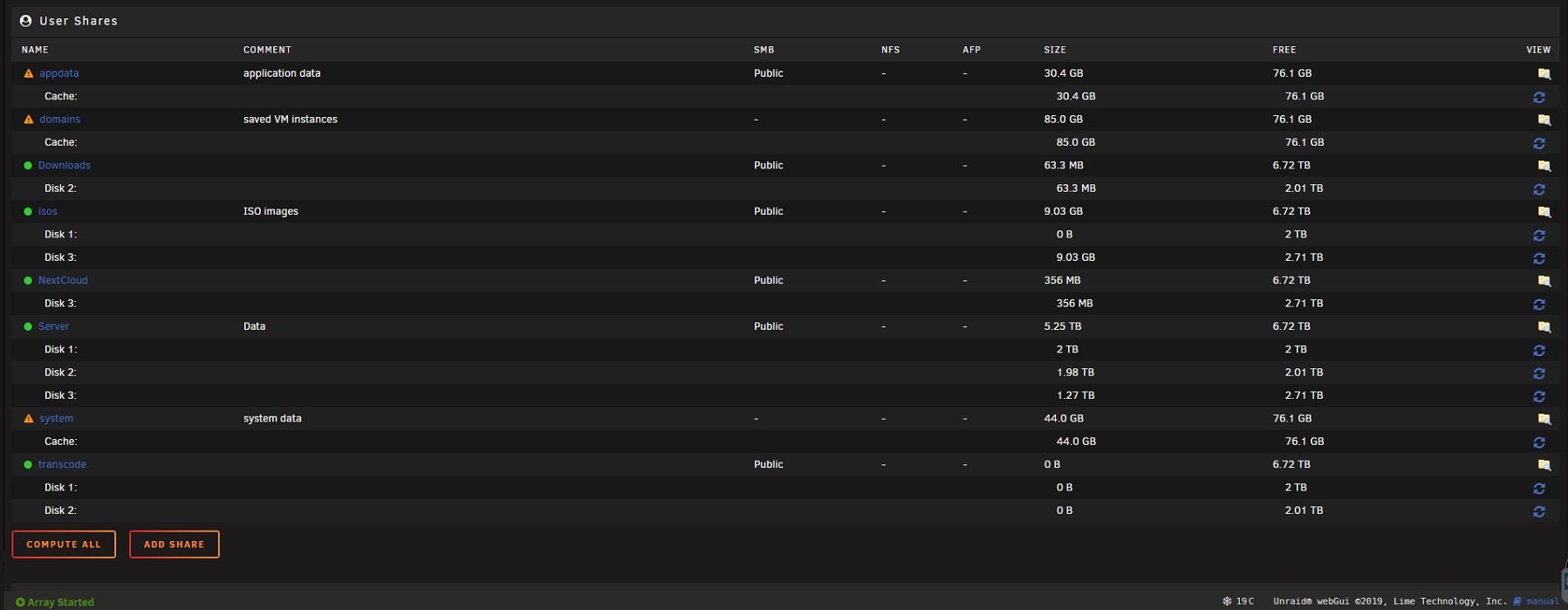

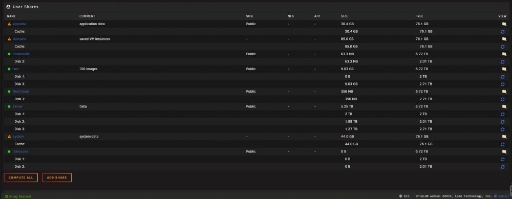

Here is the results

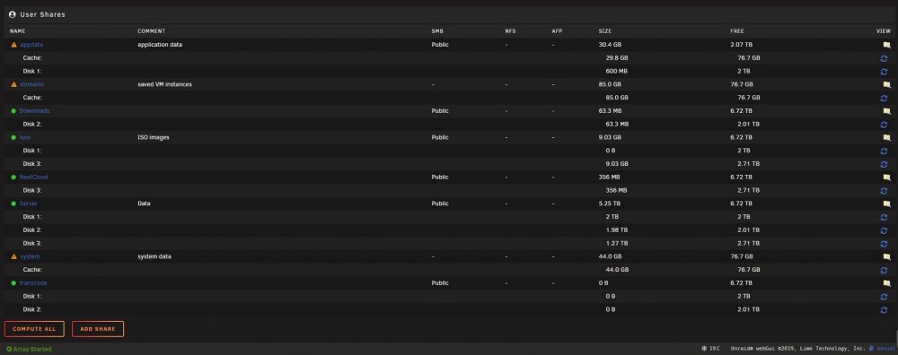

Some of appdata is still on disk1. Maybe there wasn't enough room on cache to move it until the Downloads folder got moved off cache.
Try running mover again, and then check that page again. Instead of Compute All, you can just click on the Compute... next to the appdata share.
When I click on the mover it runs and does nothing.  It appears that there is nothing to move. It lets me click Move Now again immediately
Sorry, just checked again, and your appdata share is set to cache-only. Mover will ignore it like that. Set it to cache-prefer and run mover again.

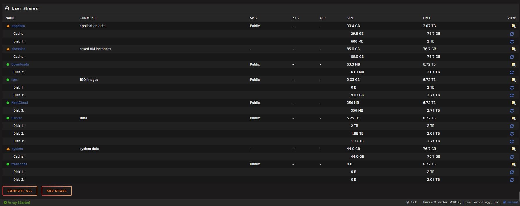

Here are the results for after
Looks good. I have to go away for a couple hours. Give us a list of your dockers.

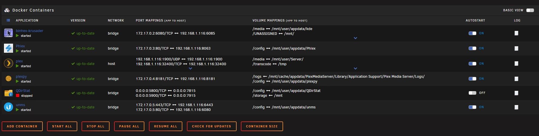

Here is the current dockers I've got installed

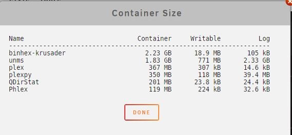

Click on the Container Size button at lower right and post a screenshot.
