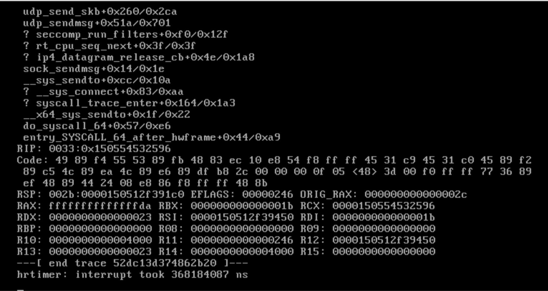

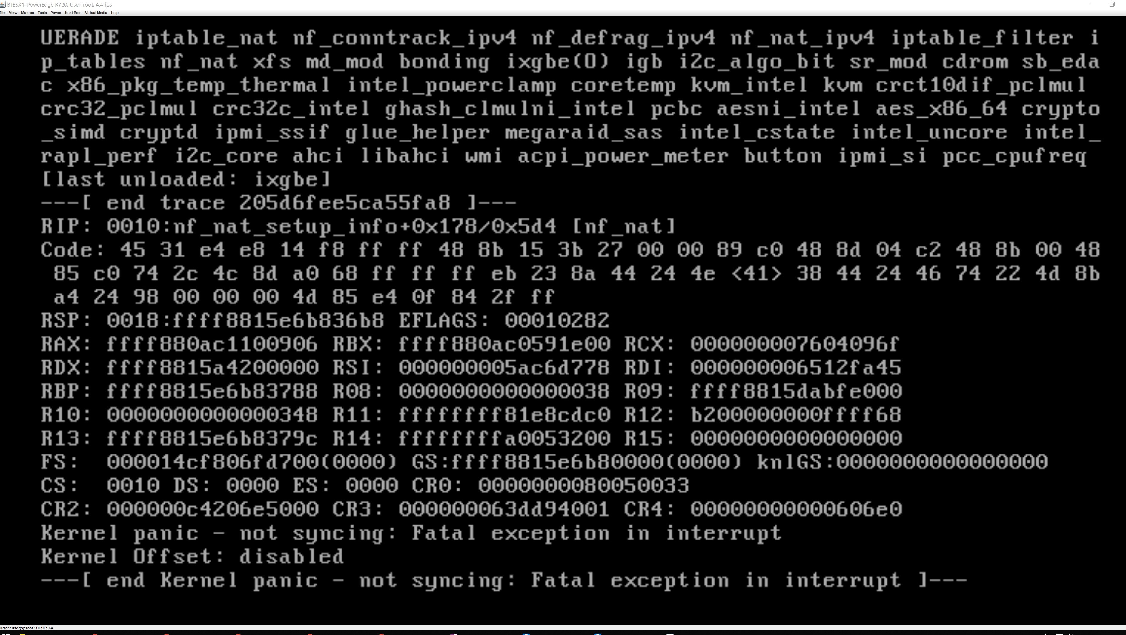

Over the weekend on Friday, the server was unavailable by website and ping.  Opening the iDrac to the server shows that the server crashed.  I do have a screen cap of that as well. Image 1. Then on Saturday the server website was down again and would not ping but I could get onto the console of the server and run commands which seemed to do nothing.  I rebooted the server.  Then on Sunday while watching a show on Plex the server crashed again.  I again have a screenshot of that.  Image 2.  I also have the diagnostics reports from the crashes.   Again tonight the server would not respond to ping or website.  I could get on the console and issue commands.  But nothing seemed to work again I reboot the server and it's running ok now.

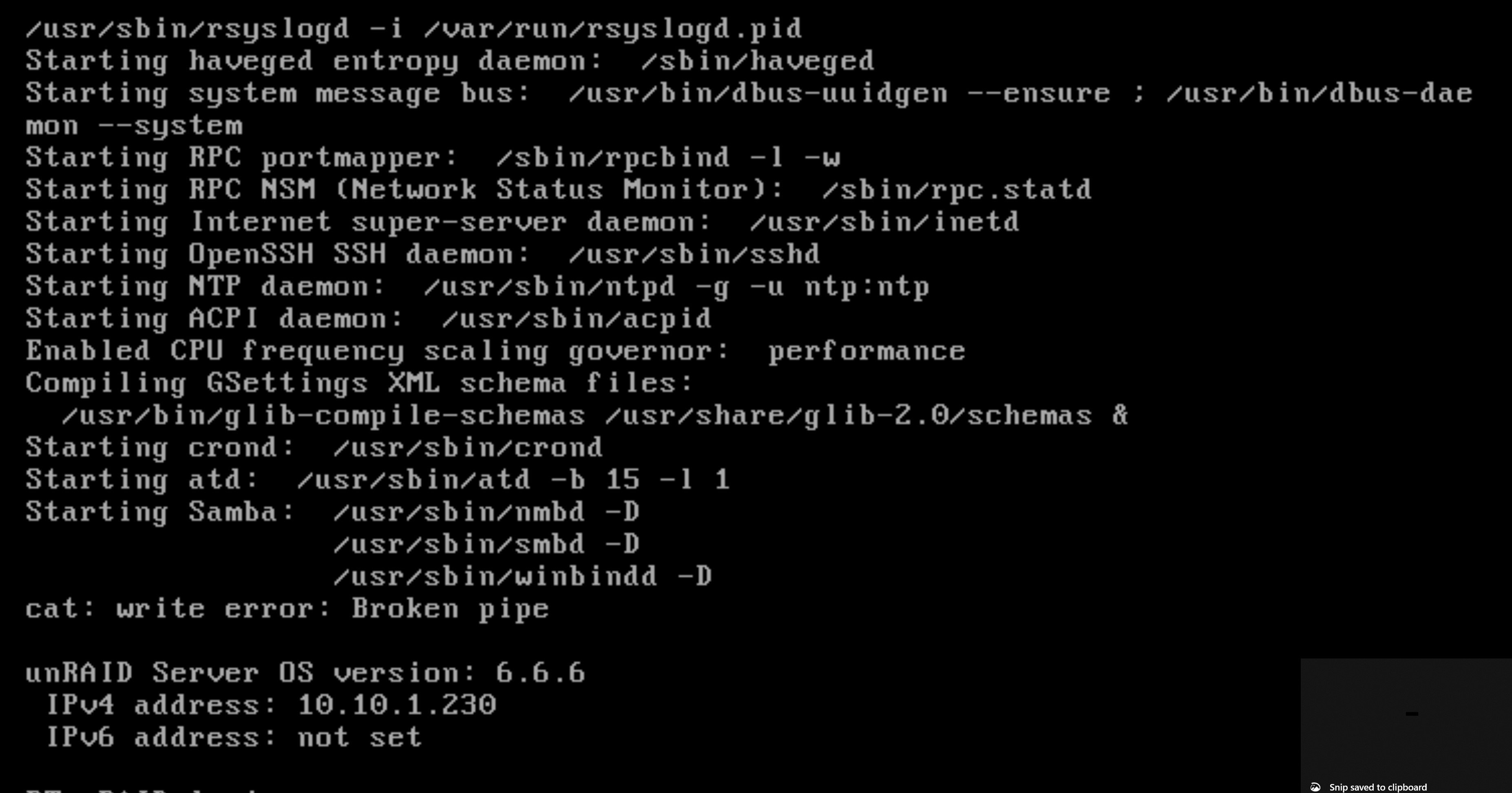

Evening, just an update it crashed 3 times over the weekend.... It seems to crash on the weekend mostly.  When it crashed today there was this error when booting up "cat: write error: broken pipe"  not sure what that means.
harmless
